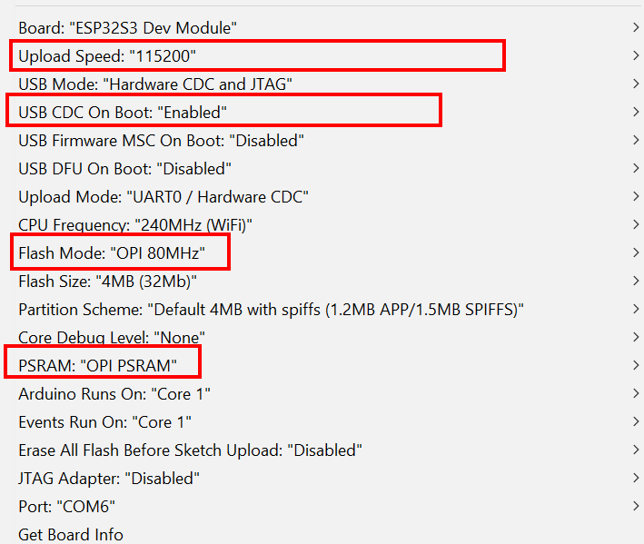

So i build a board with an ESP32-S3-Wroom-2 module.
Boot strapping pins
GPIO0 - testpoint/button
GPIO46 - NC

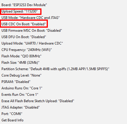

Arduino IDE Setup
Arduino IDE 1.8.19
official espressif "ESP32 Arduino" 2.0.11
the only things i changed was CDC on boot and reduced speed to 115200
Arduino IDE board settings

Googling that 'assert failed' seems to indicate you selected a larger amount of flash than your board has. Can you check that?

ESP32-S3-WROOM-2 should use OPI flash (and OPI PSRAM if 8MB).

Module is marked with M0M32R8V which is the 32 MB (Octal SPI) version with 8MB (Octal SPI) PSRAM
I changed the settings accordingly and now it works! Thanks!
