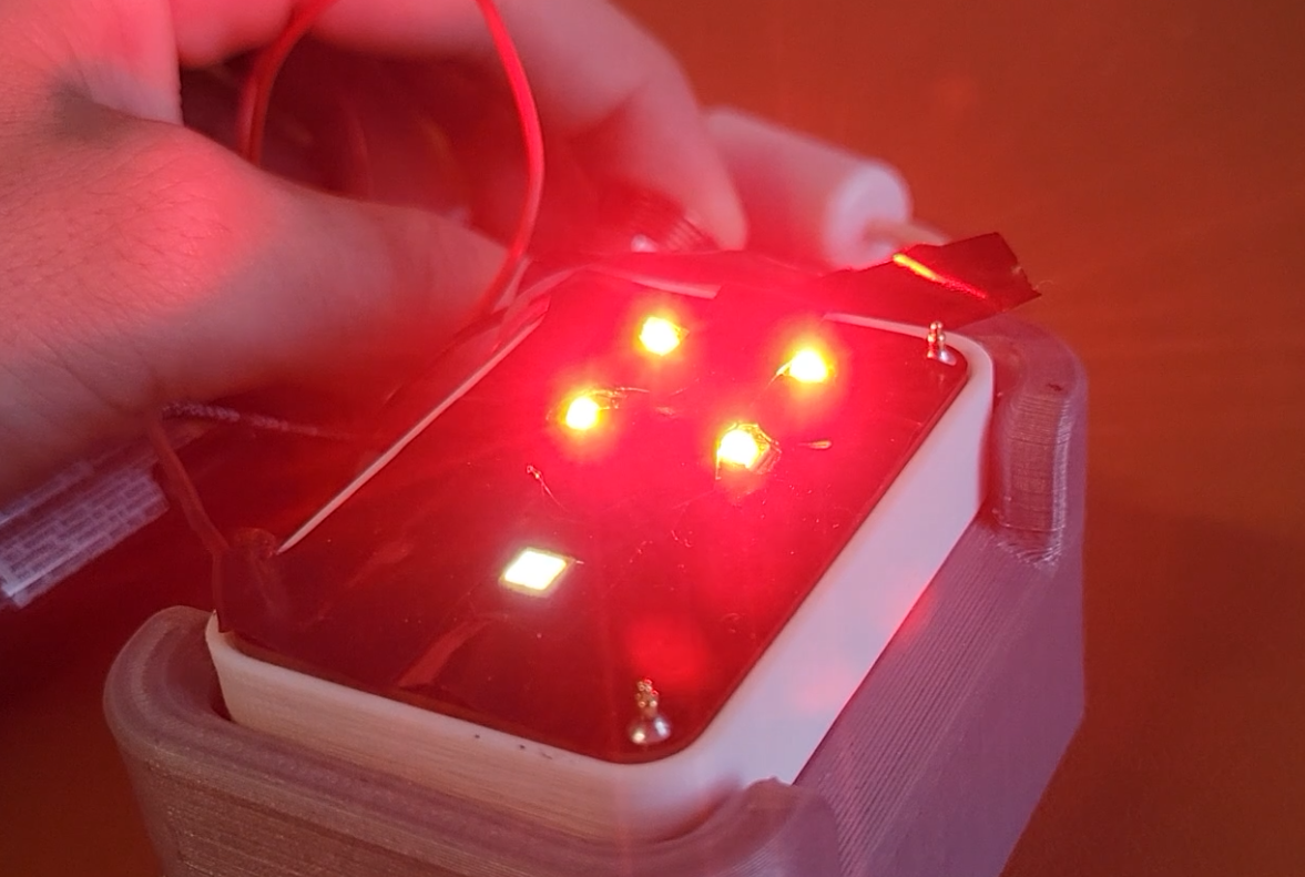

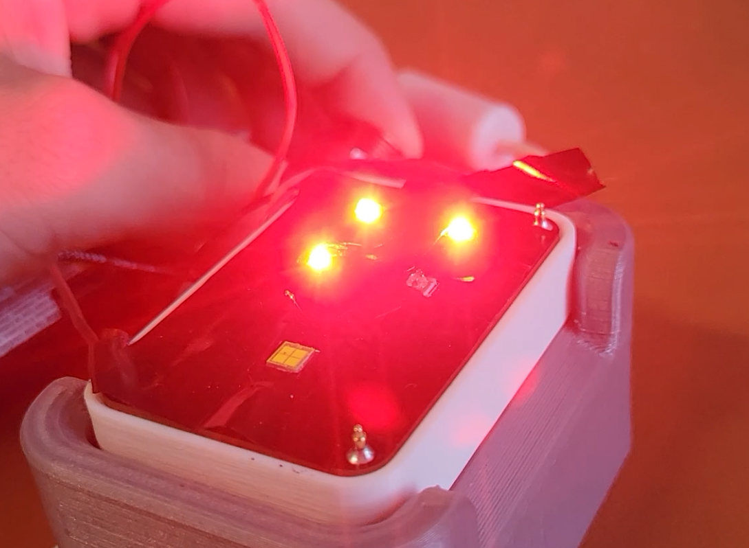

zmaker
Posts: 6
Joined: Tue Aug 29, 2023 3:42 pm
Re: touchRead breaking analogWrite?
Postby zmaker » Thu Sep 21, 2023 1:18 am
I slightly changed the code to the below (just to make the timing go quicker).
In the first test I ran the exact code below, and after the first run, only 3/5 lights came on (this is after the touchRead(4) ran)
In the second test, the only thing I changed was commenting out the print line... then all 5 lights continuously toggled
// TESTING
// the number of the LED pin
const int LEDwhite = 14;
const int ledPin1 = 15;
const int ledPin2 = 16;
const int ledPin3 = 17;
const int ledPin4 = 18;
// setting PWM properties
const int freq = 5000;
const int ledChannel = 0;
const int resolution = 8;
void setup() {
  Serial.begin(9600);
  ledcSetup(ledChannel, freq, resolution);
  ledcAttachPin(ledPin1, ledChannel);
  ledcAttachPin(ledPin2, ledChannel);
  ledcAttachPin(ledPin3, ledChannel);
  ledcAttachPin(ledPin4, ledChannel);
void loop() {
  analogWrite(LEDwhite, HIGH);
  delay(1000);
  ledcWrite(ledChannel, 128);
  delay(1000);
  analogWrite(LEDwhite, LOW);
  ledcWrite(ledChannel, 0);
  Serial.printf("touchRead: %d\n", touchRead(4)); //DISABLED THIS FOR TEST 2
  delay(500);
this is a photo from test 2, the second time the void loop() ran
this is a photo from test 1, the second time the void loop() ran
lbernstone
Posts: 1131
Postby lbernstone » Thu Sep 21, 2023 2:15 am
I'm unable to reproduce. If you are driving those LEDs through the esp32, then I would suggest a power issue. I have run many LED projects using the esp32 (and variants), and have not encountered this, although I generally prefer a button over capacitive.
