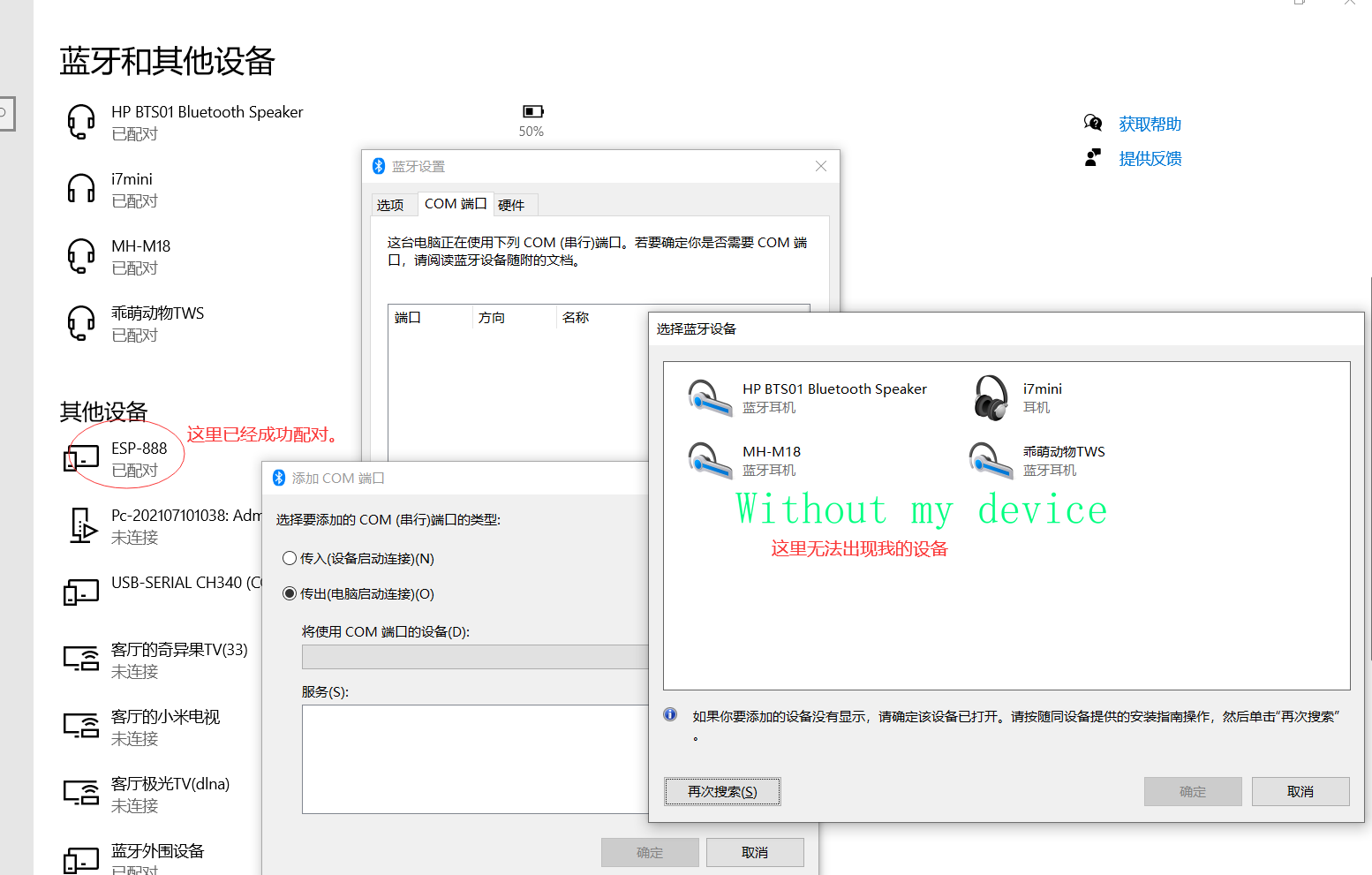

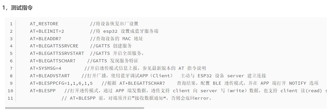

I am using the esp32c3 AT firmware to connect to a PC (Windows 10) to achieve transparent transmission of Bluetooth and serial ports.
I used the following command and successfully paired with Windows 10, but did not generate a com port. When manually added, the esp32 device that successfully paired cannot be displayed.
