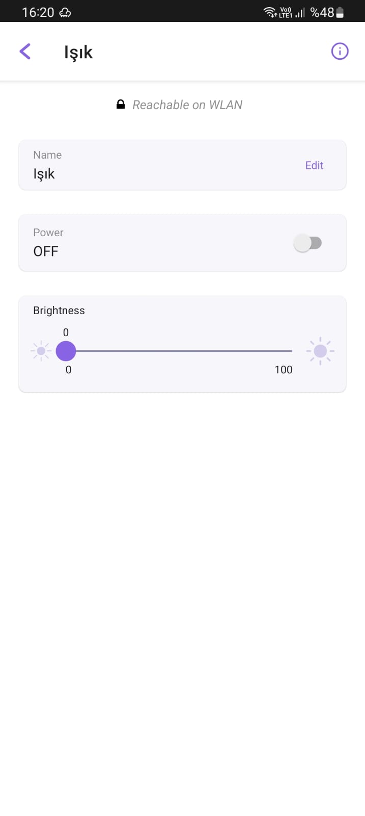

Hi everyone
I am developing a led driver for the outdoor using. Temparature is the biggest problem for us. So, i cut the 220 to 12v driver power when the light is off. On the rainmaker app, i added two param (brightness and power) I set the power param as primary assign param.
How Can i disable the brightness ui_toggle when the power param switched off? (like when the device was offline but just brightness)
thank you very much for your answer.

Unfortunately, this is not possible right now. Some time back, we had done an experiment with our iOS app to selectively show/hide some params based on values of other params. May be we will revisit that feature.
