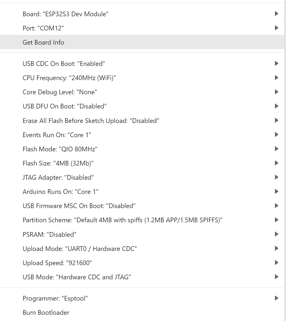

Are you sure Serial should be the UART and Serial1 the native USB? I might be missing something here, but I've done a few more tests connecting both ports of the ESP32 to the PC (without the GPS board), with these results:
- Including USB.h seems to have no effect
- Serial0 seems to me to be the UART
- Serial seems to me to be the native USB
- Nothing seems to go out through any of the two ports when using Serial1
I've reduced the test code to this:
#include "USB.h"
#define UART_USB Serial0
#define Native_USB Serial // Only Serial seems to send something through the native USB. With Serial1 I get no readings
void setup() {
  UART_USB.begin(115200);
  Native_USB.begin(115200);
void loop() {
  UART_USB.println("Per UART");
  UART_USB.println(Native_USB.available());
  Native_USB.println("Per native USB");
  while(Native_USB.available()) {
    size_t l = Native_USB.available();
    uint8_t b[l];
    l = Native_USB.read(b, l);
    UART_USB.write(b, l);
  delay(1000);
With this code I see the "Per UART" and "Per native USB" messages on two Realterm sessions listening to one of the ports each on the PC. But when disconnect the native USB port from the PC and connect the GPS board instead Native_USB.available() remains 0 and nothing new appears on the UART USB.
I've attached the configuration I'm using in the Arduino IDE.
Any other ideas? Or did I get your first reply wrong? Thanks a lot!
