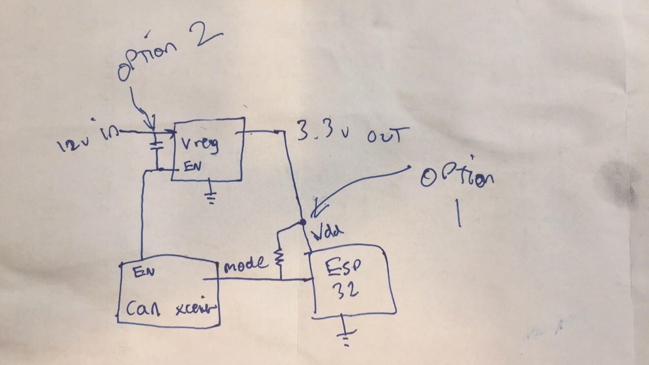

Ok how about this workaround...
Two options could theoretically work, let me know what you guys think.
Option 1, add a weak pull-up resistor to the "MODE" control from the ESP32 to the CAN transceiver.
I assume at boot up, all the GPIO's on the ESP32 are initially configured as inputs. So with a pullup resistor on there, as soon as the CAN transceiver powers up the voltage regulator, it sees +3.3v on its "mode" pin and transitions to normal awake/running mode...this should give the ESP32 a chance to boot, set the GPIO as an output, and keep it high. Then when the ESP32 wants to power down the system, it pulls the GPIO "low" (current is limited via the resistor though to prevent the ESP32 from shorting/burning out), and then the CAN transceiver kills the voltage regulator as its supposed to when it sees its "mode" pin go low.
I figure if I use a 680 ohm resistor, that should limit the current flow through the ESP32's GPIO to around 5mA when it pulls the pin low to make the CAN transceiver go to sleep and disable the voltage regulator.
Option 2, add a capacitor between the regulator enable pin, and +12v input. Then, when the CAN transceiver gets the CAN bus wake up signal and applies +12v to the voltage regulator enable pin, this charges the capacitor which holds the voltage regulator enable input "high" for an extra 200mS to give the ESP32 a chance to boot and "take over" (set the CAN transceivers mode pin high) even though the CAN transceivers initial "power up" pulse to the voltage regulator enable input is only a short 100mS long.
Thoughts?
In my option, it was pretty dumb of the CAN transceiver's manufacturer to design it so the "enable" transition period/delay is such a short interval before it says "ok I got no response from the microcontroller, back to sleep/regulator off".
Unless there is a way to make the ESP32 boot faster? The 500mS I measured really is agonizingly slow...

I know this is way old, but the deep sleep with an interrupt is the best solution. deep sleep uses near zero power. It could last on a small battery for months and months without being woken up. I think Deep Sleep power consumption is 10-15 uA. Also, get a better voltage regulator if you have quiescent power issues. You should be able to find a regulator with 10-40 uA of quiescent current for an LDO type, maybe 100-200 uA for a buck regulator that allows for 12v input. But you probably don't need a buck since the car will be running when the device is using power.
Your whole solution would be less than 250 uA quiescent current when all in deep sleep, likely much less if using an LDO. Your car will still have no problem being unpowered for months.
