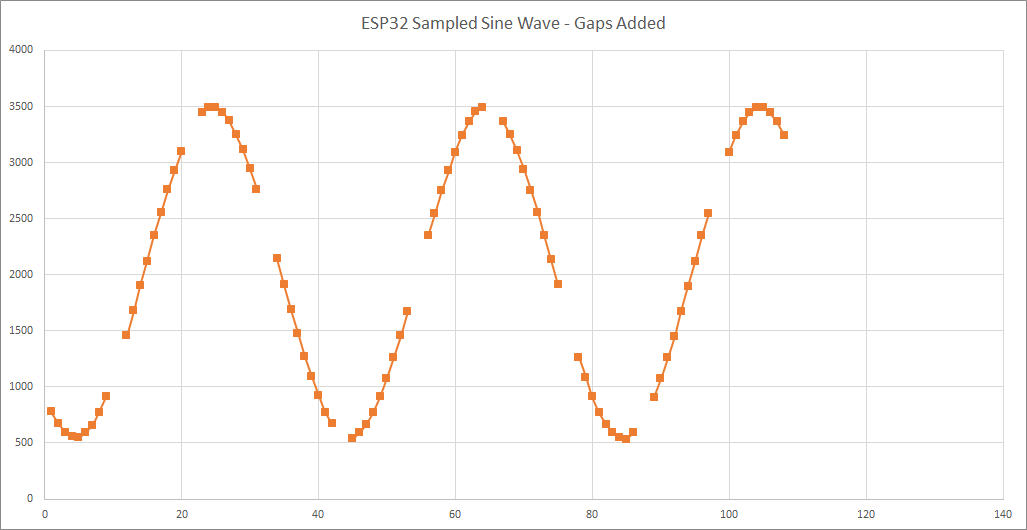

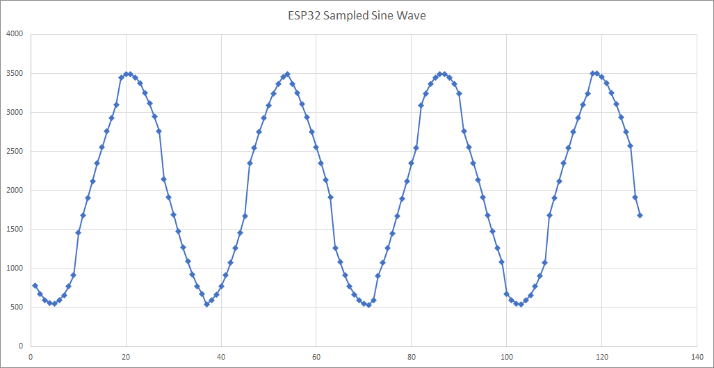

I have been pasting the 128 samples into Excel and plotting the sine wave to check what it looks like.
It looks like the ADC sampling is dropping or missing every 10th and 11th sample, i.e. 9 samples look OK, then there is a jump which looks like 2 samples are missing. The plot looks OK if I insert a 2 row gap every 9 rows. See attachments.

Why am I losing every 10th and 11th sample?
Sampled sine wave with jumps
Sampled sine wave with 2 empty points added every 9 points

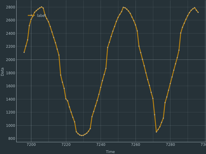

Any update to this? Has anyone had success by setting "SYSCON.saradc_ctrl2.meas_num_limit = 0" as @ESP_Sprite suggested?
This did not work for me - the ADC "conversion done" callback doesn't occur if the bit is set to 0.
davidribeiro
Joined: Thu Dec 14, 2023 3:36 pm
Re: ADC in continuous mode MISSING SAMPLES - 255 Sample LIMIT
Postby davidribeiro » Thu Dec 21, 2023 1:59 pm
I'm having the same problem. Tried your code, used SYSCON.saradc_ctrl2.meas_num_limit = 0 before calling adc_continuous_start(), and, although the ADC works if you change the register before initializing it, the missing samples persist.
