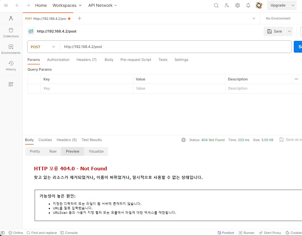

hello every
I'm doing project using ESP32 C3 is access point, config as Http Server. My laptop will access wifi from ESP32 and send data through HTTP POST.
But when I use Postmand to testing. The problem is "HTTP 404.0 - Not Found" although I register uri POST and GET at ESP32 code.
I tried at framework 4.4.6 and 5.1.2 but can't solve problem. Attachement file is problem from Postman

Log data from VS code, look good, ESP32 created successfull server

I (1526) wifi_AP_WEBserver: wifi_init_softap finished. SSID:ESP32 password:mypassword
I (1536) wifi_AP_WEBserver: Starting server on port: '3500'
I (1546) wifi_AP_WEBserver: Registering URI handlers
I (1546) wifi_AP_WEBserver: Registering URI OK

I (52296) esp_netif_lwip: DHCP server assigned IP to a station, IP is: 192.168.4.2
Code: Untitled.c Select all
Posts: 10618
Re: Can't HTTP Post from Postman to ESP32 with AP Mode
Postby Sprite » Fri Dec 29, 2023 9:19 am
192.168.4.2 is the IP assigned to your computer. You're trying to connect to your computer, rather than the ESP32. Try http://192.168.4.1 (or http://192.168.4.1:3500)
