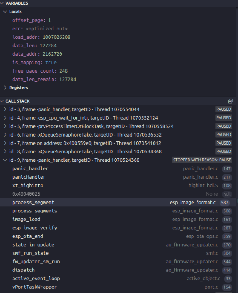

Update: I attached a JTAG debugger, which confirms failure happens in esp_image_format.c/process_segment function.
In addition, EXCAUSE is set to 0x04.

Tracing the exception a bit more, it appears it is triggered in function process_segment_data, and more specifically during the loop on line 639. I am able to set a breakpoint there and program execution never progresses after the loop's bounds, and function bootloader_sha256_data is never called.
Core is never dumped; tried both Flash & UART as destinations.

Another lead: the code execution ends in panic_handlers.c:
        // For cache error, pause the non-offending core - offending core handles panic
        if (panic_get_cause(frame) == PANIC_RSN_CACHEERR && core_id != esp_cache_err_get_cpuid()) {
            // Only print the backtrace for the offending core in case of the cache error
            g_exc_frames[core_id] = NULL;
            while (1) {
                ;	/* THIS IS THE END */
I can see that the EXCCAUSE register is set to 4, but the condition requires PANIC_RSN_CACHEERR (which is defined as 7 in panic_reason.h)

Tracing esp_partition_get_sha256, it leads to calling process_segment_data(), which is where esp_ota_end() also crashes.

Finally I found the reason - I was doing memcpy to a string literal. This gave no warnings (and also somehow worked). When the code was fixed, esp_ota_end does not fail.
