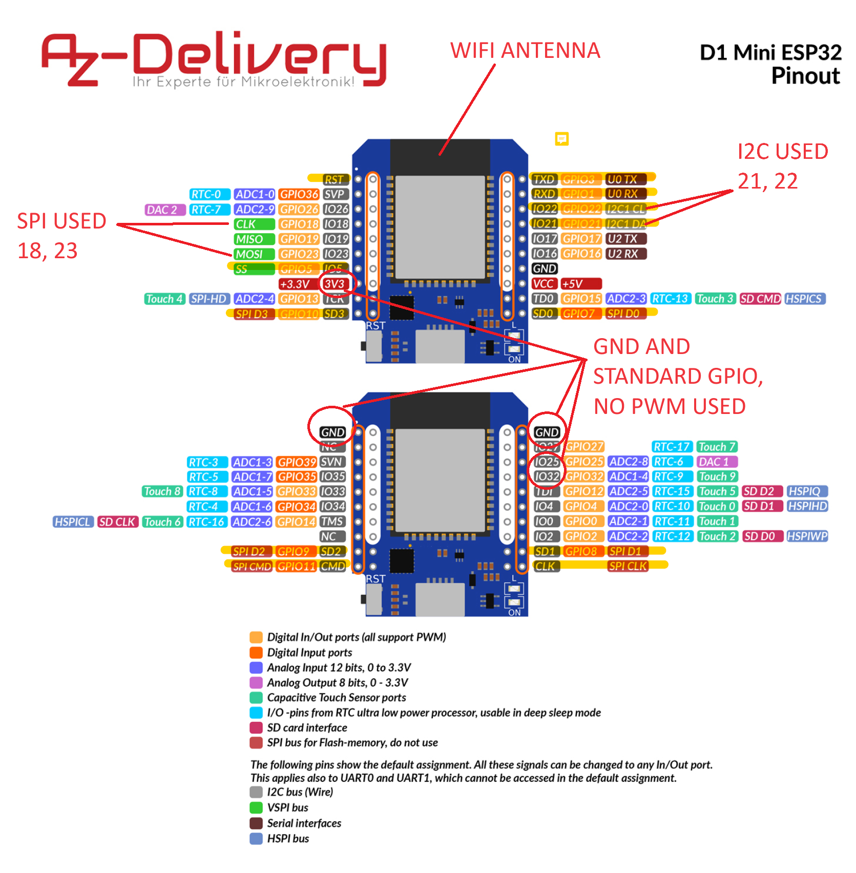

Anyone who knows how to keep the wifi waves away from the spi on a 3 centimeter preprinted esp32 d1 mini board is welcome.

No neopixel. I am using a standard WS2801 chip that receives all the data for the 10 successive meters of equal chips.
If the first signal comes through right (from SPI to the first LED) then the whole line is correct. No Problems there.
But if i turn on WIFI, the SPI picks up noise before the line leaves the box and the first LED transmission is corrupted.
How and where this occurs, in library or on air i don't know yet.
What i know:
-Standard ws2801 chip for the leds.
-the wifi library is #include <WiFi.h>
-the spi library for the leds is #include "Adafruit_WS2801.h" i've tried FASTLED with equal wiring before, that was not better.
-i am using Dupont jacks so far, will be trying to omit them and solder directly.
update: Leaving the dupont plug lines out and soldering the wires directly to the board does not solve the issue.
-The I2C seems about fine although its closer to the antenna than the SPI. (I2C used for a gpio extension for a keypad)
-the board name and pin locations, see Anything ring a bell?
