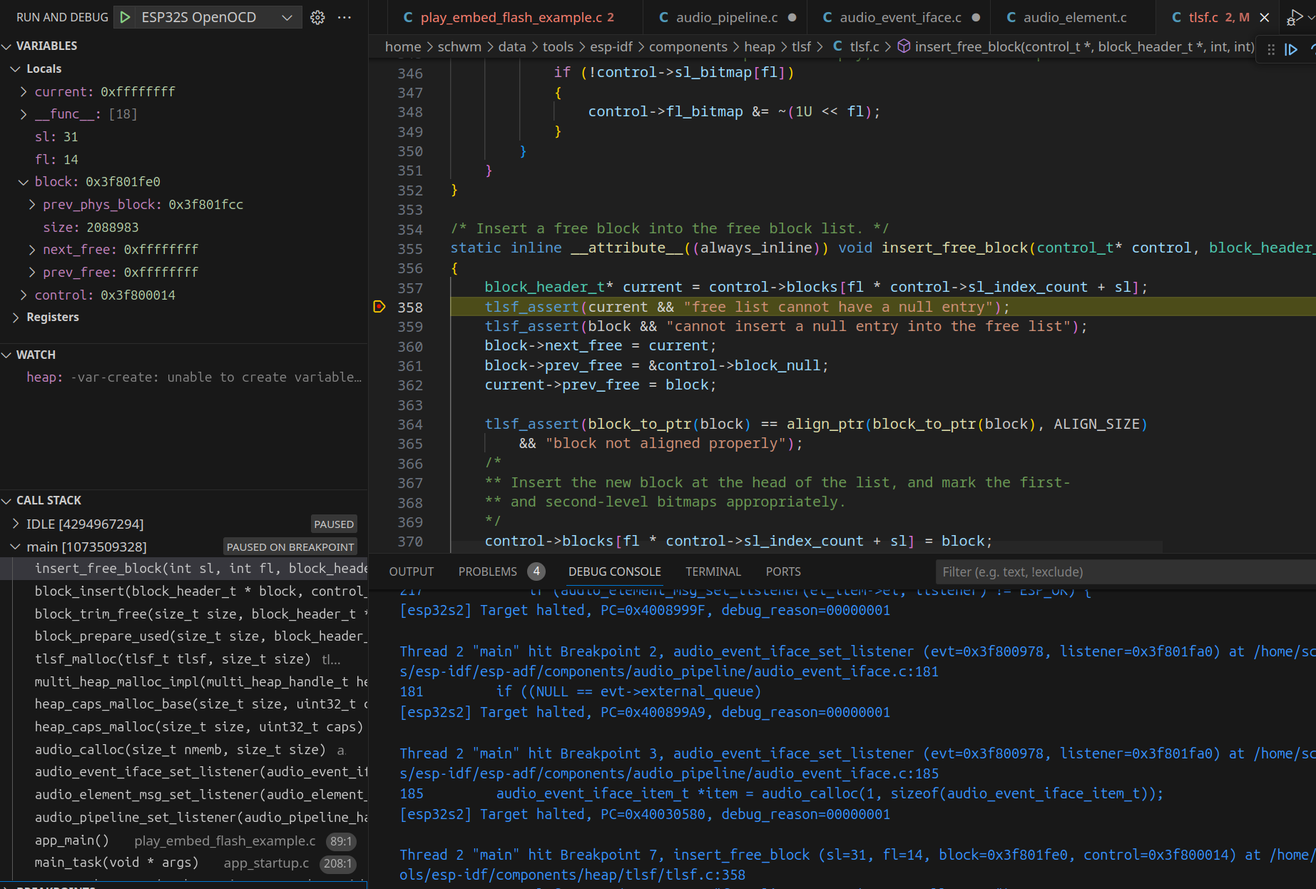

i have an issue with the example project play_embed_flash_example.After (1342) PLAY_EMBED_FLASH_MP3: [3.1] Listening event from all elements of pipeline i got an exception and i do not know why.

When i debug to the point where it fails i have added a picture. Why is current 0xFFFFFFFF?
i have tried it now also with the esp32s2 kaluga -1 v1.3. With this dev board it is working. It seems i have an issue by adding a custom audio board. What is the prefered way to create a custom audio audio board.
When i switch to the my board with a ES8388 as audio ic and the ESP32-S2-WROVER i have the issue. It is strange what could cause to such a behaviour.

Hi MSD-Systems
This phenomenon can not accurately judge the problem, but there are some lessons to share with you. This seems to be a memory problem, it is recommended to check the code first, you can turn on the IDF heap debug function.
