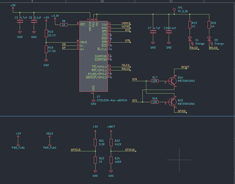

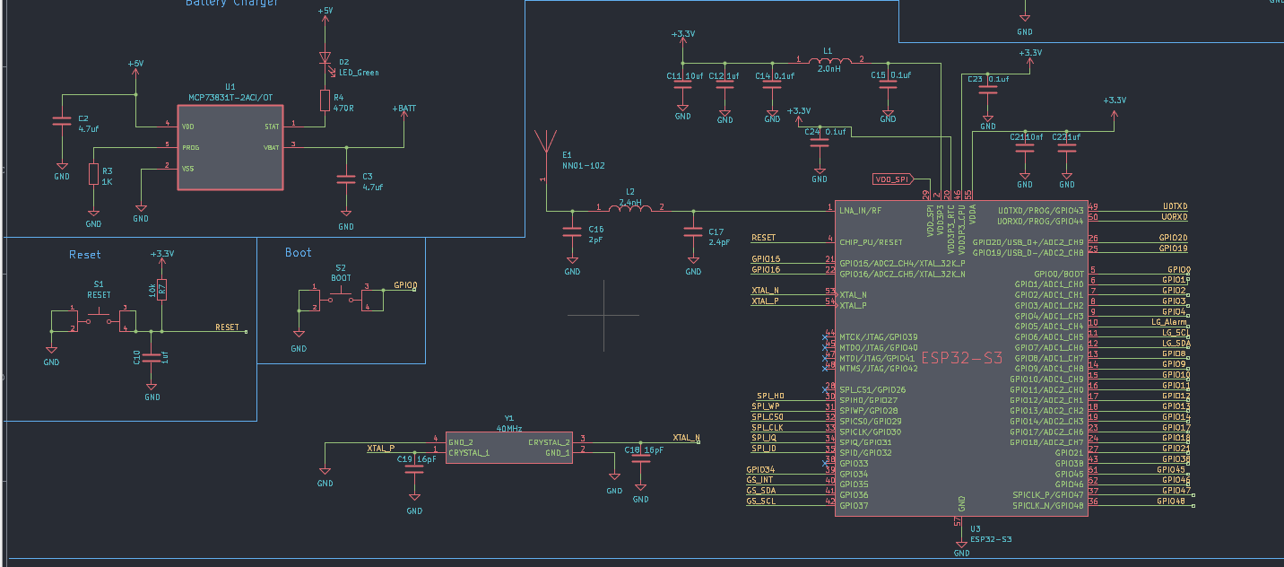

Hi Everyone,
Thanks for your time; I appreciate any help to guide me in the right direction.
I have designed a custom PCB with ESP32-S3 and CP2102N-Axx-xQFN24 as the UDB to UART bridge.
The design includes an external SPI FLASH, which I'm using W25Q128JVSIQ in this case.
The COM port is detected without any issues, and the RX and TX led's flash while I try to connect to the board from Arduino IDE, but I get the following error message:

Am I seeing this correctly, are you using the CP2102 as a source of 3.3V? If so, that thing can only supply 100mA, while the ESP32-S3 is specified to require a >=500mA power supply. Could very well be that this is your issue.

Hi ESP_Sprite,
Thanks for checking the Schematic.
I am only using the CP2102 3.3 output for the RX and TX LEDs are connected to the same chip. The rest of the circuit uses a MIC5216-3.3YM5-TR for power, which is rated at 500MA.

Postby alex6262 » Mon Jan 22, 2024 10:12 am
After more checking, I found that my SPI_CS0 PIN (32) is high (3.3V) when the board is plugged in.
Checking my Fash datasheet, the CS pin is active low; I'm not sure if ESP32 will manage that internally, pulling it low when required, or if it should be low at all times.
Posts: 10618
Re: ESP32-S3 Boot loop Issue
Postby Sprite » Tue Jan 23, 2024 3:57 am
That's expected; the ESP32 pulls it low when needed. If you scope it, you should probably see it go low for a few short times when the ESP32 tries to boot.
