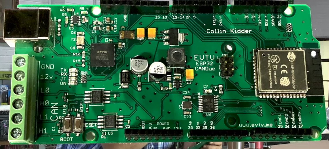

Posts: 1698
Re: About the CAN controller.
Postby rudi ;-) » Tue Feb 20, 2018 1:15 pm
hi folks,
nice found, for your info:
It is called EVTVESP32CANDue Board
watch the Jack Rickard Tv stream at this position
