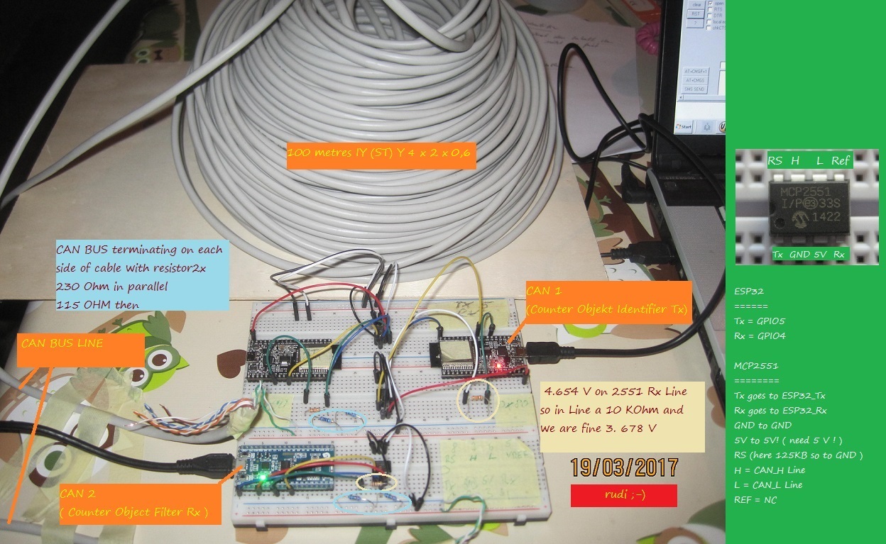

ThomasB wrote:I also use the MCP2551.
An example is planned but currently im drowning in work...
thomas,
have tested it just in time here with MCP2551 too ( before with TJA1051 )
works like a charme too.
now we go next steps..
No problem! I was able to get this working :D The code provided was perfect - I just needed to wire up my MCP2551 correctly.
fast test,
perhabs this helps:
https://twitter.com/eMbeddedHome/status ... 2771785728

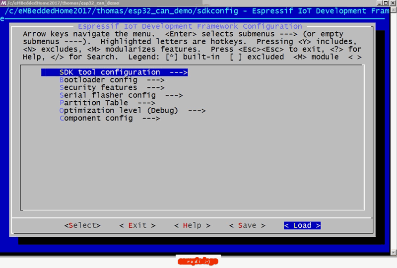

hi
ESPCan driver as component and menuconfig ready for PullRequest to ESP-IDF components
comes asap

ESP_Sprite wrote:Nice! Thank you very much. I'll see if we can integrate it into esp-idf.
hi jeroen
CAN Driver base ready
CAN Driver menuconfig ready
do you have start integrate work?
if not we do this PR to github or Third party IDF components list
what is the best`?
