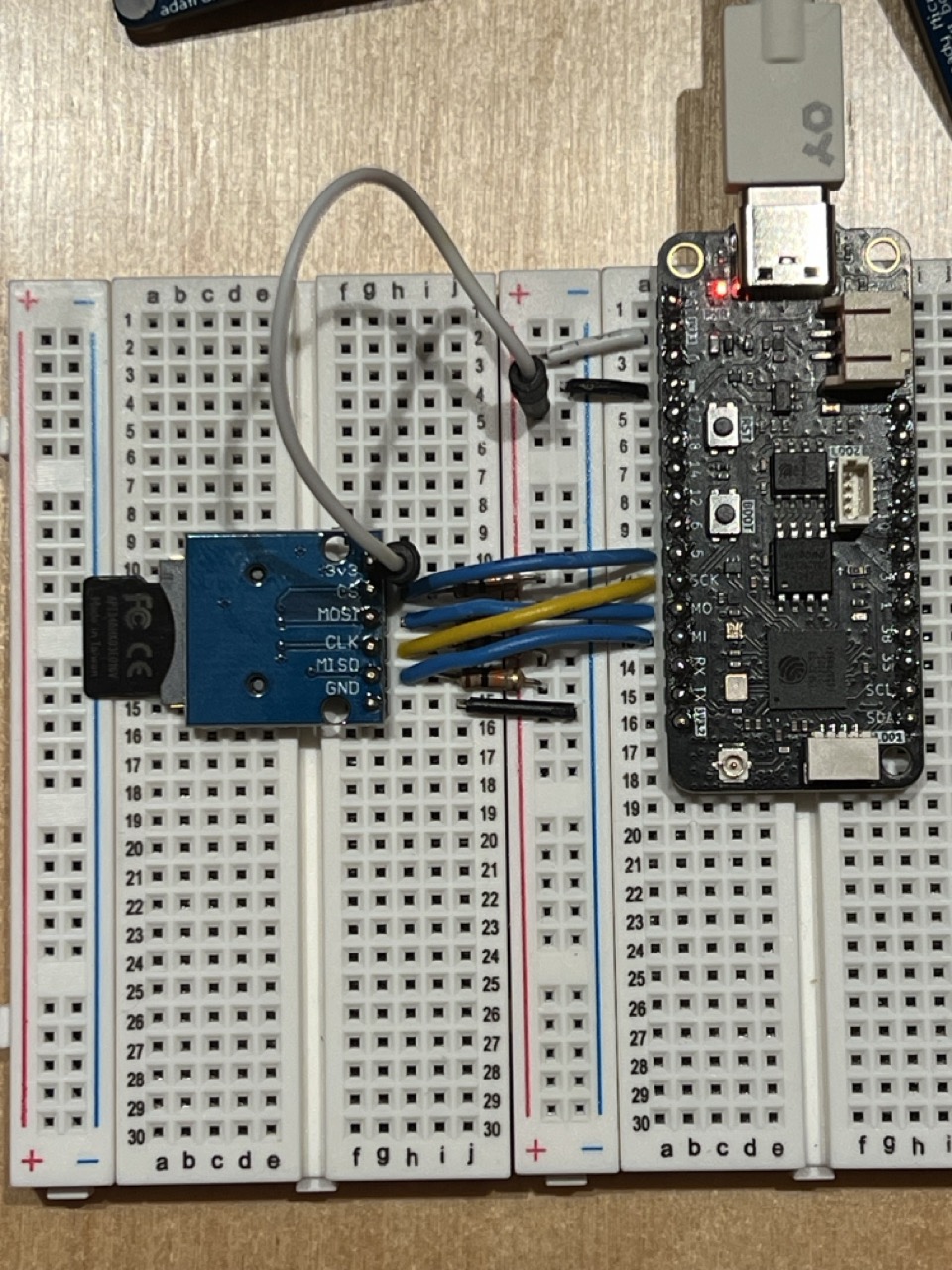

I'm so flabbergasted by what I'm experiencing with trying to interact with an SD card and in esp32-s3 that I'm not even sure how to fully articulate it. I'm using esp-idf 5.1.2. I'm trying to get the sd_card example running. I have at least a dozen microSD cards I'm trying - Sandisk, MicroCenter, a bunch of others in various sizes. I have 4 different microSD breakout boards. Every permutation of these causes the example code to fail:
E (30361) vfs_fat_sdmmc: sdmmc_card_init failed (0x107).
E (30361)   SB - sd-read-write: Failed to initialize the card (ESP_ERR_TIMEOUT).
Commenting out swaths of the code and sprinkling log statements everywhere, I think I have pinpointed my issue to the formatting of the card - when this operation happens, the error is thrown, and the card becomes corrupted. I have to re-format it in my laptop to bring the card back to a usable state, but this example code very, very consistently behaves like this.
The thing that flabbergasts me the most, however: I've put log statements every few lines - when I bypass the format step, I see all of the log statements run. BUT, if I include the format line, NONE of the log statements print anything! The code almost immediately seems to jump over itself straight to this error. The only way I can get the thing to run how I might expect is by periodically inserting large delays in the code (even then, the format causes corruption, but I can at least see it making its way through the code as I expect).
I just can't imagine why this might be happening - is there something in the ESP that can cause code to run non-linearly?

A probable explanation for what you're describing is buffering of print functions. If you call `fflush()` function before the format function, it should flush the buffer and print. You can also use `setvbuf()` function to disable buffering on STDOUT if you want to.
I guess you adding `vTaskDelay()` makes the buffer flush automatically.
The current format function is kind of problematic in a sense it doesn't "yield" (the formatting is done via external FATFS library) and therefore WDT - watchdog timer can trigger, resetting the ESP mid-format and corrupting the filesystem. You can increase WTD timeout for tasks or disable it entirely (not recommended). Increasing allocation unit size speeds up the formatting a lot but also sets minimal size of a written block in the filesystem (with 16kB allocation unit size even if your real file size was 1kB, it takes up 16kB of space - if it has 17kB, it takes up 32kB etc.) - since you already have it set to 16kB it depends on the average file size stored there if you would want increase it further though. Speed of the format is also dependent of the SD card size.
Right now you're using the example to test your ESP with SD cards and that's why you're using the format as well - are you going to format SD cards by your ESP32 regularly? In what environment do you intend to run your project? FAT filesystem is prone to corruption when stopped (e.g. power cut-off) mid-operation (we are developing a journaling component which will help with this but at current time it is not publicly available). If you can upgrade to IDF v5.2+, we have an example there which uses LittleFS filesystem designed for embedded devices (unfortunately backport of the official example is not yet merged to v5.1, but it should be possible to use `esp_littlefs` even in v5.1) which should be more fail-safe - a downside is it is currently limited to only 2GB in partition size.
Also I see you're using SDSPI instead of SDMMC example - is there any reason? If you can, I would advise using SDMMC protocol as it is native to SD cards (SPI is like a fallback mode) and it should be faster.
