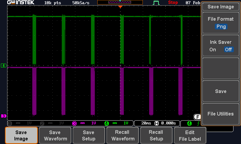

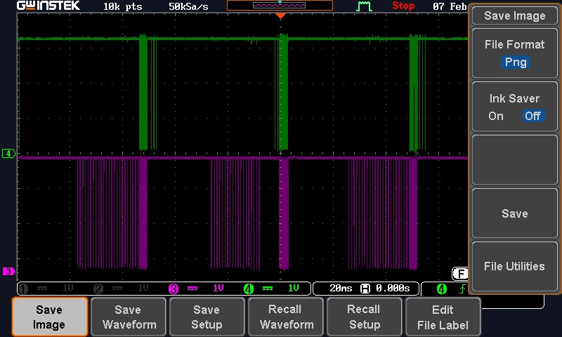

Postby jimboino » Wed Feb 07, 2024 2:55 pm

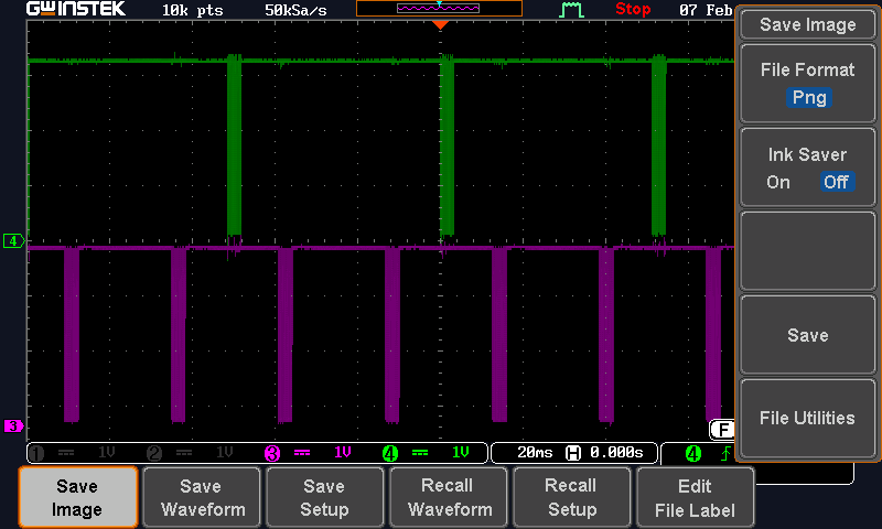

in a project I want to use 3 different accelaration sensors over I2C (ADXL343, ADXL313 and MMA8451). They are connected to an Arduino Nano ESP32 (ESP32-S3). I'm using Arduino IDE V2.2.1 to programm the Nano ESP.
For reaching high data rate I want to use both I2C ports. In my code I'm using the integrated FIFO from these sensors to read 20 samples fast (something like "bulk read"). The sensors creating a signal when there are 20 new values in FIFO. So the signal forces an interrupt on ESP.
The following description and example uses just two sensors (ADXL313 and ADXL343).
When I create a tasks for each sensor an put them on differenet cores everything works fine. But when I create them on the same core the both I2C ports seems to be "synced". The "bulk read" is only fast when both ports are reading, so there is a timing problem when using different data rates. The following records showing the problem. (upper port (green signal) works with a sample rate of 400 Hz, the bottom (purple signal) with 800 Hz)
created on different cores
created on the same core
The thick vertical event in the signal is a bulk read with 20 fast readings, the thin line is just a single read. The first record shows the desired behaviour. The bulk readings are indipendent. In the second record, the bulk readings are synced and only working when both ports are communicating. When only one port communicates there are delays between each single read until the other port is reading too. Then fast read is performed.
When changing task prioritys, the single reads aren't there anymore, but communication is only executed, when both ports are reading, not at interrupt, when it should be done.
created on same core with different priority

Finally the question is: Why are the I2C ports seems to be "synced" when using them on the same core? There is no problem with slow reads, but reading with max sample rate (3200 Hz) produces a watchdog reset.
Best regards,
Patrick
jimboino
Joined: Wed Feb 07, 2024 11:00 am
Re: Timing problem using both I2C ports on one core
Postby jimboino » Mon Feb 12, 2024 8:14 am
Hey,
any ideas?
Or bad description? Or bad english :)?
Wrong subforum? Maybe it is not an arduino specific problem and comes from ESP-Kernel?
Give me a feedback please :)
Best regards,
Patrick
