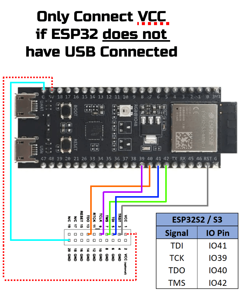

I am trying to use ESP32S3 with platform IO , when i try to program with JTAG ESPPROG
[env:esp32-s3-devkitc-1]
platform = espressif32
framework = arduino
board = esp32-s3-devkitc-1
monitor_speed = 115200
upload_port = COM6
upload_protocol = esp-prog
debug_tool = esp-prog
debug_init_break = tbreak setup
This in my platformio.ini file
The terminal showing this error.

Error: double-check your JTAG setup (interface, speed, ...)
Error: esp32s3.cpu0: IR capture error; saw 0x00 not 0x01
Error: Unexpected OCD_ID = 00000000
Warn : target esp32s3.cpu0 examination failed
Warn : target esp32s3.cpu1 examination failed
Error: JTAG scan chain interrogation failed: all zeroes

I have sorted this problem myself thanks.
