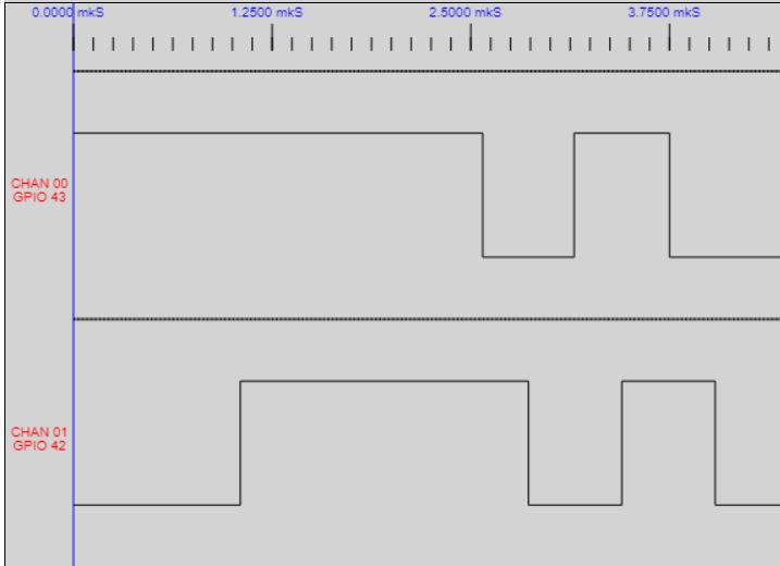

Postby ok-home » Sun Mar 24, 2024 12:28 pm
menuconfig
CONFIG_ESP_CONSOLE_NONE=y
or
CONFIG_ESP_CONSOLE_USB_SERIAL_JTAG=y
    gpio_reset_pin(43);
    gpio_reset_pin(42);
    gpio_set_direction(43,GPIO_MODE_OUTPUT);
    gpio_set_direction(42,GPIO_MODE_OUTPUT);
    while(1)
        gpio_set_level(43,1);
        gpio_set_level(42,1);
        gpio_set_level(43,0);
        gpio_set_level(42,0);
        vTaskDelay(1);
gpio42 gpio43

Postby FrankJensen » Sun Mar 24, 2024 7:58 pm
Thank you, ok-home :-)
I have been staring at the menuconfig, and now I just found the possibility to set log UART to NONE. (Default UART0)
I have output :-)
br. Frank.
