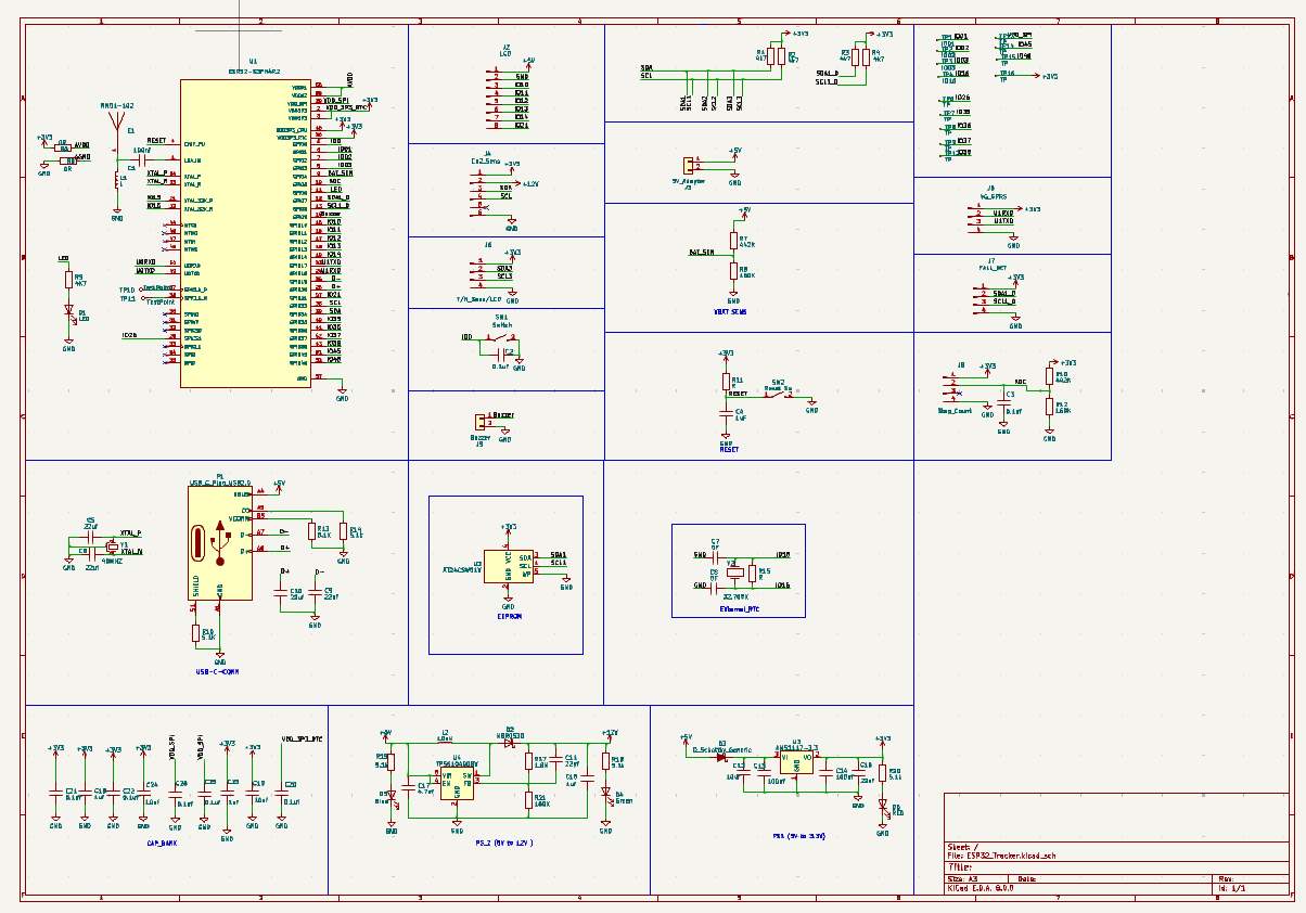

I designed a project using the ESP32-S3FH4R2, but I'm unable to flash any program onto it. I've attempted to download the programming via UART, but I'm encountering difficulties. I've also tried using an FTDI for communication, and while the COM port detection occurs, I'm still unable to flash the device.

Your image is unreadable potato quality; suggest you share it as a PDF rather than an image. Aside from that, please check the basics: are your voltage rails okay? Do you see 40MHz on the main crystal? Do you get any output on the serial port on power-on or reset?

I'm receiving an output voltage of 3.3V. Will it still function properly if I omit the 40MHz crystal?

If I try communicating in USB mode (using D+ and D-), I don't receive any messages from the ESP32. Even when connected in UART mode (using an FTDI programmer), the situation remains unchanged. What modifications are required to establish communication with the device?

No. The ESP chip will fail to do anything if it can't generate a proper 40MHz sighal.I'm receiving an output voltage of 3.3V. Will it still function properly if I omit the 40MHz crystal?
On your schematic:The values of C5 and C6 are way off. 22uF capacitors will kill the oscillation entirely; didn't you mean to put 22pF there?
(Not relevant to your booting issue, but you also want to get rid of C2. It'll stop your ESP32 from booting into your application when the device is powered on. Also, D3 seems to be unnecessary here. Also also, R16 should be a short, not a 5.1K resistor.)
