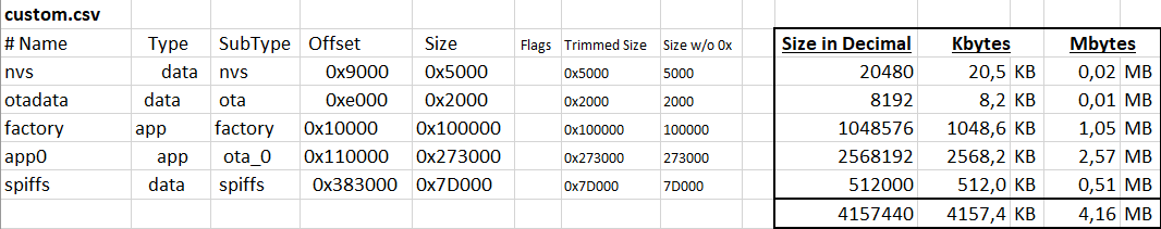

I need to change the partitions of my ESP32 filesystem, to support larger app.
I need OTA..
My board has 4MB flash.
I come up with this, but I'm not sure this is correct, and will support my needs?

If you need OTA, you need two OTA partitions, ideally of the same size. (The factory partition is not required for OTA, though, so unless you know you need a factory partition, you can convert that into an OTA partition, giving you two 1.5MiB-sized OTA partitions.)
Do you need to store files into internal flash? If not, you can also get rid of the spiffs partition.

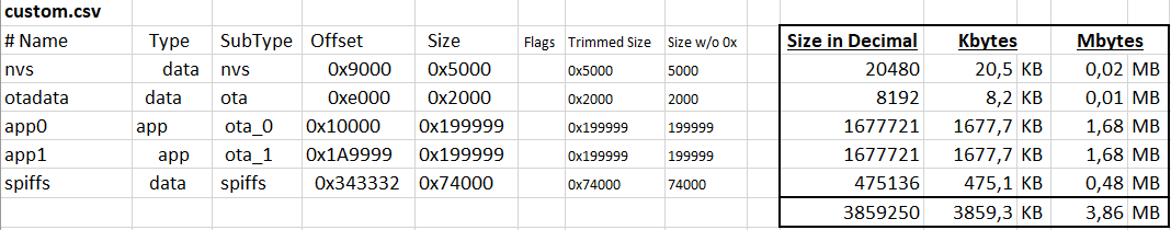

Okay, I don't think I need the factory, so I will try to make two ota partitions. Like this?:
I was planning to use the spiffs to save a config file. Would that nok be a good place to store it?

Dependent on what configuration you need, nvs could also be a good place to store it.

There is also a pre-built called 'Minimal SPIFFS (1.9MB APP with OTA/190KB SPIFFS)'

The plan is to just store an .json file...
Posts: 10609
Re: Partitioning ESP32
Postby Sprite » Fri Apr 19, 2024 11:44 am
If the JSON is a single key/value store, you'd probably best off using the NVS (or specifically for Arduino, the 'preferences' library) rather than a spiffs. Just take the keys that you would put into the JSON file and feed them into the Preferences lib instead.
