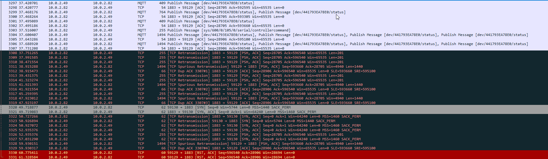

I have a problem with MQTT disconnect while connected to network via WiFi. I think that disconnect occurs when ESP32 client doesn't get ACK after message is sent. When transport_base timeout got triggered, MQTT reconnect is performed and ESP32 device is offline for 10 - 30 seconds. After that it connect to MQTT broker and continue to work. This disconnect event happens periodically, but time between disconnect vary from 2 to 15 or more minutes.
here is Wireshark output (10.0.2.82 is broker, 10.0.2.49 is ESP32 client)
2024-04-23 09_32_01-mq3.pcap.png (99.72 KiB) Viewed 1405 times
and here is ESP32 log output with DEBUG log level:

D (1699050) transport_base: poll_write: select - Timeout before any socket was ready!
W (1699050) transport_base: Poll timeout or error, errno=Success, fd=54, timeout_ms=2000
E (1699056) mqtt_client: Writing didn't complete in specified timeout: errno=0
D (1699065) mqtt_client: Reconnect after 10000 ms
D (1699069) event: running post MQTT_EVENTS:2 with handler 0x400d7e18 and context 0x3ffb8948 on loop 0x3ffb8848
D (1699079) MQTT: Event dispatched from event loop base=MQTT_EVENTS, event_id=2
I (1699086) MQTT: MQTT_EVENT_DISCONNECTED
My question: is there any solution for this exept disconnect/connect? 10 - 30 seconds is too much time my device is "offline" for my application.

Hello, I am currently facing the same issue. May I ask if you have resolved this problem?
