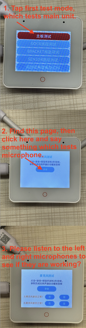

To troubleshoot the microphone hardware issue, please flash the following factory test firmware (Sorry that testing firmware language is in Chinese only). Normally, each device undergoes rigorous factory testing before leaving the factory, but in order to facilitate troubleshooting, please use this firmware to conduct additional testing. Below is the test guide:
1. Enter the first test mode, which tests the main unit.
2. Locate the specified page and click on it. Then, verbally say something to test the microphone.
3. Pay attention to the functionality of the left and right microphones. Do they both appear to be functioning properly?
Should the microphone fail to function correctly, please reach out to us through the AliExpress platform's backend to arrange for an exchange. Thank you.

Hi, We've noticed that the recent batch of microphone issues is caused by the screen protector. Please remove the screen protector when using the microphone function. If the mic issue persists, please return the product to us. Thank you!

I ran the test diagnostic and unfortunately my Box-3 microphones appear to be faulty. I made sure to remove the screen protector.

Nevermind, the microphone works, it was I that misunderstood how the testfirmware worked.
all good now!
