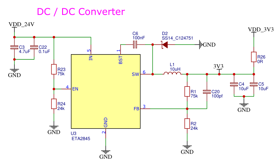

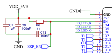

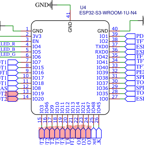

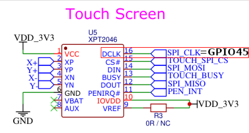

We are struggling with an esp32s3 that randomly blocks in bootloader.
After a long power off, the blocking behavior occurs often at its first boot (≈1/5 boots)
And almost never when the CPU is powered off during a short time.
The previous hardware revision is working fine (tested on 50 boards).
On the 2 boards of the new revision, one of our esp has the booting problem.
Do you have any idea how to deal with this problem ? Thank you

You can find our schematic in the attached image.
Red GPIOs are floating (used for a daugther board, we did not connect it).
All other GPIOs are rooted, mainly to IC.
Thanks
Pins rooted

Here is our EN pin routing :
GPIO 45 is directly connected to an XPT2046:
We use a 24V stabilized supply to power an ETA2845, output 3.3V:

Hm, that EN RC network is somewhat underdimensioned: could be that the chip comes out of reset before everything is properly stabilized. You could try lengthening the reset pulse a bit: e.g. change R6 to an 10K or change C13 to 1uF.
(On an unrelated note: your PSU is somewhat underdimensioned. That chip can only deliver 0.4A while the S3 datasheet specs a PSU capable of delivering at least 0.5A. If later on you get brownout reboots, especially on WiFi init, that is likely the cause.)

We still reproduce the bug with increased R6 (up to 100K).

One more thing: can you make sure GPIO45 is grounded when booting up? That pin should have a built-in pulldown, but perhaps the attached chip has some kind of glitch making it high on power-up.

Concerning GPIO 45,
We burnt "Fixed 3.3V VDD_SPI" (with "espefuse.py set_flash_voltage 3.3V").
They are the only eFuses we burnt.
The bug is still reproducible, nothing has changed.
If we understand documentation correctly, GPIO 45 is now ignored as a strapping pin.
