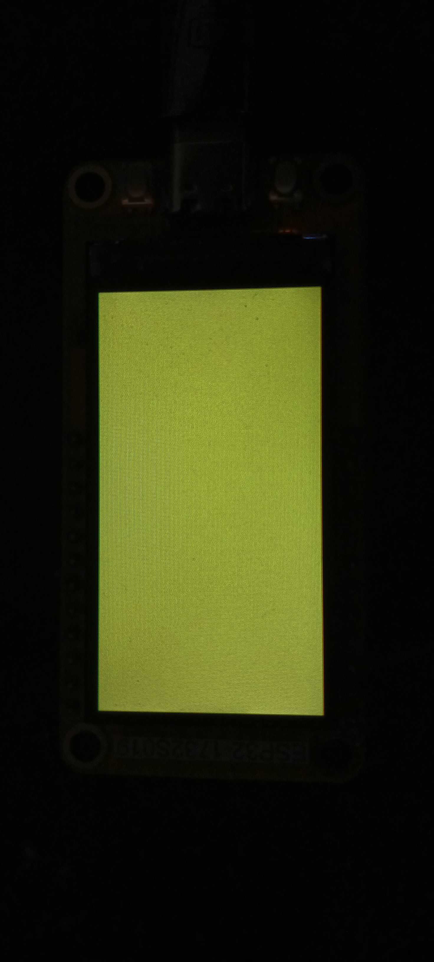

I have a ESP32-S3-R8N16 board with a TFT screen 170x320. When I use Adafruit_GFX library everything works fine but I want to use DMA on the screen to have more reactivity and I try to display many thing but come back to the beginning and now I just want to display red screen but I have this:
I don't understand where is my error, can you help me please ? You can find my code here:

sendCommand(0x2A); // Column address set
sendData(0x00);
sendData(0x23); // Offset because there is 35px before and after ((240 - 170) / 2)
sendData(0x00);
sendData(0xCC);
sendCommand(0x2B); // Row address set
sendData(0x00);
sendData(0x00);
sendData((HEIGHT - 1) >> 8);
sendData((HEIGHT - 1) & 0xFF);
sendCommand(0x2C); // Memory write
digitalWrite(TFT_CS, LOW);
delay(100);
digitalWrite(TFT_DC, HIGH);
delay(100);
uint16_t lineBuffer[WIDTH];
for (int y = 0; y < HEIGHT; y++) {
for (int x = 0; x < WIDTH; x++) {
// RED in RGB565
lineBuffer[x] = 0xF800;
sendLine(lineBuffer);
delay(500);
void sendLine(uint16_t* lineBuffer) {
spi_transaction_t t;
memset(&t, 0, sizeof(t));
t.length = WIDTH * 16;
t.tx_buffer = lineBuffer;
spi_device_transmit(spi, &t);
digitalWrite(TFT_CS, HIGH);
