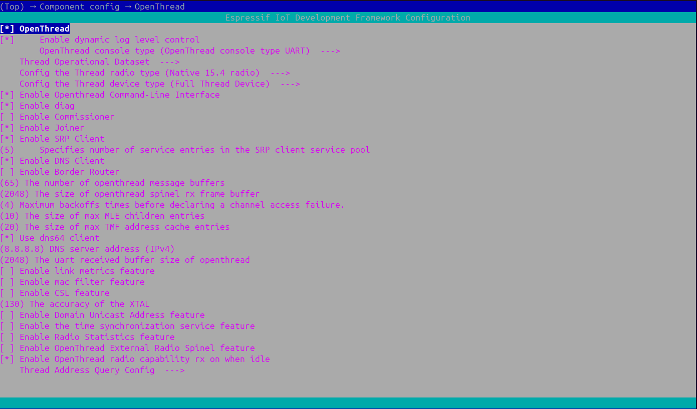

Here is my menuconfig for ot_cli:
Screenshot from 2024-06-12 16-43-26.png (133.14 KiB) Viewed 1485 times

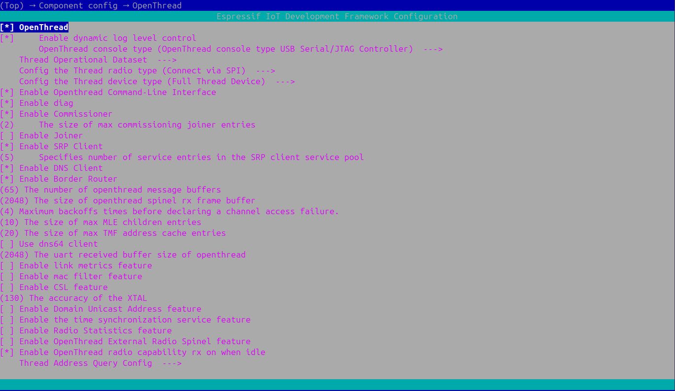

Here is my menuconfig for basic_thread_border_router:
Screenshot from 2024-06-12 16-48-32.png (134.75 KiB) Viewed 1485 times

First, for a thread network, whether or not you use a router board doesn't make much difference if you only use the data and controls internally. The router board only routes the data that must transcend the thread network externally, which is your case. So, for the ping to work for the IPv4 network outside the thread network, you must ping from a node and not from the router board.
For example: access the ESP32-H2 or C6 that you configured in the thread network and ping Google's DNS (ping 8.8.8.8) as you have already done. I believe you will receive the ping request response.
The ping performed directly from the router board does not work with the Espressif implementation example. To do this, you have to change the programming so that the ping can be done by the router board.
The router board in this case only acts as a data traffic facilitator between the two networks. However, even if you want to ping from the IPv4 network to the IPv6 network of the thread, you also have to perform other possible configurations.
So in your case, the ping should always be performed on one of the nodes of the thread network and not on the router board.
If it doesn't work, try performing the basic configurations again on each device and it will work. I myself reset and configured the settings several times to understand.
