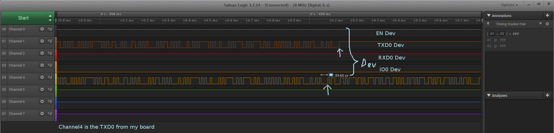

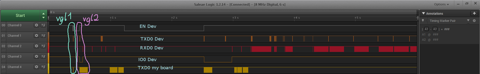

Because that the flash don't work I analysed the communication data stream. For this I connected the EN, IO0 and RXD0 parallel from the ESP32 by the devboard to the ESP32 on my board and I have seen that the answer on TXD0 isn't right.
whole communication
At first the bits are exactly the same but when the devboard ESP finishes its package the ESP on my board sends furthermore.
vgl_2

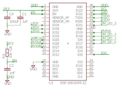

For me it's clearly that I have a hardware problem but I don't know where. Have I forgotten to connect a pin or have I connected a pin which is not allowed?
(only the ESP)
(pin 32 is not connected)

Postby -Rudy- » Sun Dec 31, 2017 7:23 pm
It probably will not help, but try connecting pin 32.
