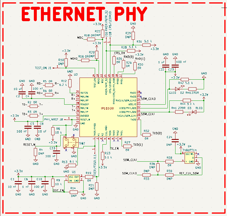

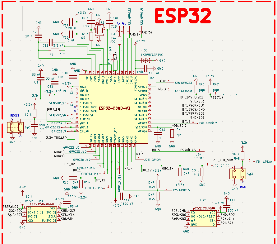

I have spent a lot of time developing some ESP32 ethernet application on a genuine ESP Ethernet development board. I wrote a very long code that worked flawlessly on my testing hardware setup. Now I am implementing all that on a custom PCB. I can flash and get logs from ESP microcontroller, so I guess there is no hardware problems related to ESP32. However, as soon as I try to run the developed code on the ESP, I get logs:

E (2554) esp.emac: emac_esp32_init(369): reset timeout
E (2554) esp_eth: esp_eth_driver_install(228): init mac failed
E (2554) example_eth_init: eth_init_internal(89): Ethernet driver install failed
E (2564) example_eth_init: example_eth_init(244): internal Ethernet init failed
ESP_ERROR_CHECK failed: esp_err_t 0xffffffff (ESP_FAIL) at 0x400d82b8
0x400d82b8: app_main at C:/Users/Admin/Desktop/ESPTCP/main/main.c:512 (discriminator 1)
file: "./main/main.c" line 512
func: app_main
expression: example_eth_init(&eth_handles, &eth_port_cnt)

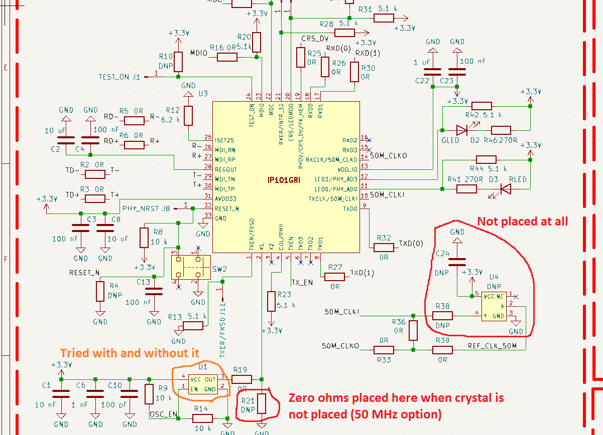

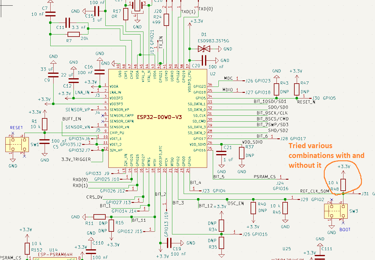

After doing initial research online, I saw that most likely the problem lies in the IP101 clock and synchronization with ESP32. Down below in the attachments, you can see my hardware schematics. I tried various different combinations of the highlighted components (placing and removing them one by one) But it did not give me any consistent results. I may be wrong, but I want to pick the internal 50 MHz ref clock as the main clock source (I should be getting that 50 MHz clock signal on the GPIO 0 as an input from the perspective of the ESP.) It happened for a couple of times but it was not consistent. Other than that I have checked my wiring, menuconfig PHY settings for reset pin and even the sdkconfig file for the right RMII GPIO pins. I am almost certain that problem lies somewhere in the hardware but I do not understand where exactly. I made the schematic replicating ethernet part of the mentioned ESP ethernet devboard (pdf in the attachments), but maybe they have implemented slight modifications to proceeding revisions (its just a guess anyway...) I highly appreciate any observations or advices on what could be wrong with my IP101 hardware schematics.

Vilius
Posts: 26
Joined: Mon Nov 13, 2023 9:22 am
Re: ESP32 can not initialize IP101 Ethernet PHY
Postby Vilius » Mon Jul 08, 2024 6:54 pm
Yes, I have. Like I mentioned, it seems there are no problems with the ESP32 itself, I am getting the right voltages, no shorts, no suspicious current consumption, other than the PHY, PCB works as intended.
ondrej
Posts: 227
Joined: Fri May 07, 2021 10:35 am
Postby ondrej » Wed Jul 10, 2024 6:43 am

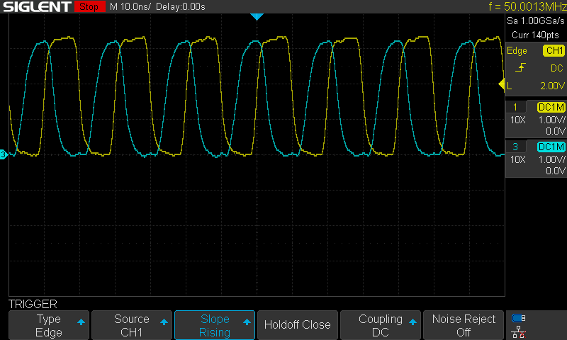

Have you measured the RMII REF CLK on oscilloscope?
Vilius
Posts: 26
Postby Vilius » Sun Aug 04, 2024 10:39 am
Sorry, for such a late response, I spent all this time debugging. Here is m update:
I am trying to replicate ESP Ethernet DEV kit (at least the ethernet part of if) on my custom PCB that I will be using for Ethernet application. I consistently followed the manufacturer's schematic (in the attachments.) All the wiring is tested like a 100 times. I absolutely guarantee that everything you see in my schematics is indeed implemented on the PCB (Schematics are in the attachments). The ESP part works flawlessly, it flashes and runs perfectly. However my problems occur in the ESP-PHY communication level. The ESP can not fully initialize the PHY, I get false logs (for example, I sometimes get ,,Ethernet link up" log when there is no ethernet cable attached etc.) The logs related with PHY are completely unpredictable. One exact log example is in the end.
I am testing my board with manufacturers provided ESP code (ESP-IDF->examples->ethernet->basic). That code has to send a dynamic IP request to the DHCP server and obtain it, but as you can tell, my ESP is not obtaining the dynamic IP. I am absolutely sure that all the connections are right, and my DHCP server is up and running. If I test the exact same code with the ESP Ethernet Dev kit, it works perfectly.
Hope I explained the problem well enough so far. I tried both running the 50 MHz clock from the PHY CLKO as the reference, but I settled on sourcing the 50 MHz clock from the ESP GPIO0 pin and using an inverter right before the PHY's CLKI pin. In any case, I made sure I get nice and continuous real and the inverted 50 MHz clocks (picture in the attachments.) I also probed the MDIO and MDC lines. I can capture occasional MDIO packets, but the clock line MDC always stays low. That is an obvious problem but I guess that is a consequence of some other mistake, rather than the cause. In any case, I have settled on this problem for a couple of weeks now and I am absolutely out of clue what could be wrong, what else can I try. Any observations about the MDC or any other possible solutions are highly appreciated.
P.S. If I missed some crucial details about this problem, just let me know.
