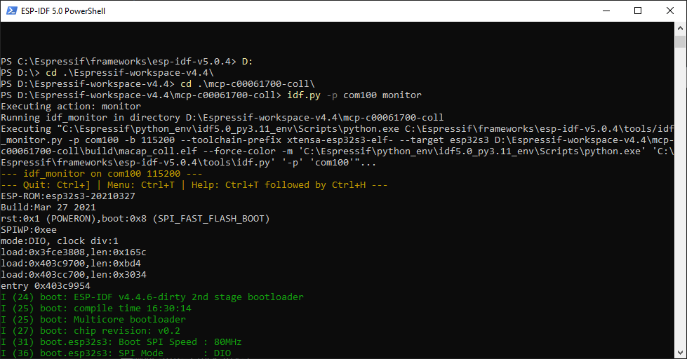

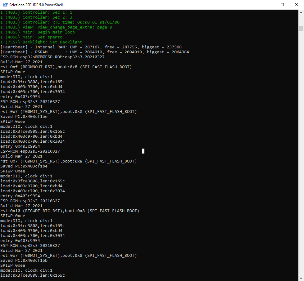

In our custom boards we are in production with, we found two samples with a strange behaviour:
when the board is powered on, sometimes the app start normally while sometimes it get stuck in the first stage bootloader and keeps resetting for TG0WDT_SYS_RST and after a few times also for RTCWDT_RTC_RST.
Anyone knows how to solve the problem?
Successful start:
successful start
img success.png (40.03 KiB) Viewed 1262 times
Stuck in first stage bootloader
stuck in first stage bootloader
img error.png (54.73 KiB) Viewed 1262 times
