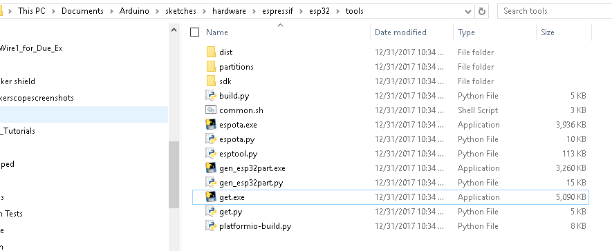

I get this error when compiling any sketch for the ESP32 Feather:
exec: "C:\\Users\\Perigalacticon\\Documents\\Arduino\\sketches\\hardware\\espressif\\esp32/tools/xtensa-esp32-elf/bin/xtensa-esp32-elf-g++": file does not exist Error compiling for board Adafruit ESP32 Feather.
I tried reinstalling the core 4 different times, the directions say that the sketchbook directory is:
Sketchbook Directory: Usually C:/Users/[YOUR_USER_NAME]/Documents/Arduino
But this is not true, this is not the usual sketchbook directory, usually it is:
C:/Users/[YOUR_USER_NAME]/Documents/Arduino/sketches.
Right now this is the directory structure:
C:\Users\Perigalacticon\Documents\Arduino\sketches\hardware\espressif\esp32\tools
See attached picture.
Anyway I can't compile any sketch if installed to either directory, it gives the error immediately that it can't find the files and I have restarted and reinstalled everything several times. Can you please help me. I have a standard up-to-date IDE installation on Windows10 64 bit.

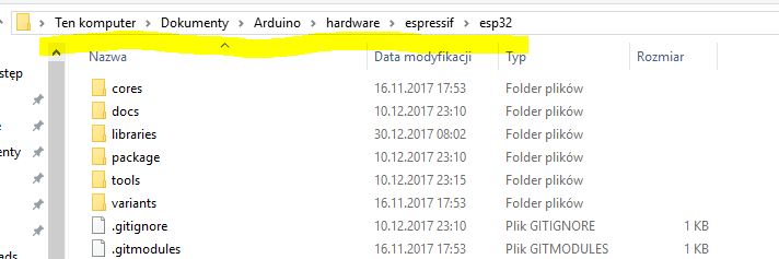

You have to move whole hardware directory one level up:
into:
Documents\\Arduino\\hardware

by chegewara
It works.
If you cant make it to work maybe just reinstall arduino and all libraries (espressif/arduino-esp32 too). I know few users that got issues with arduino-ide and they got fresh installations and problems gone.

by perigalacticon
So I deleted the \Documents\Arduino\sketches\hardware\expressif directory and re installed it to the \Documents\Arduino\hardware\ directory and now I have the expressif\esp32\tools directory; however, now there is NO LIST of ESP32 boards in the Boards Manager Menu. They were there when I installed it the sketches hardware directory, but not now. And I have restarted the IDE, and the computer.
I have another set of Arduino program directories at C:\Program Files (x86)\Arduino\ because it's a 64bit machine and it makes you install it that way, however all of my sketches are in the Documents directory, but all of my libraries are in the x86 directory. So where exactly is this supposed to be installed, because it's not working for me.

I have the same problem, however I think problem is related to get script failing dus to SSLerror
C:\Users\leo\Documents\Arduino\hardware\espressif\esp32\tools>get
System: Windows, Info: Windows-10-10.0.16299
Platform: i686-mingw32
Downloading xtensa-esp32-elf-win32-1.22.0-75-gbaf03c2-5.2.0.zip
File "get.py", line 139, in <module>
get_tool(tool)
File "get.py", line 89, in get_tool
r = requests.get(url)
File "site-packages\requests\api.py", line 70, in get
File "site-packages\requests\api.py", line 56, in request
File "site-packages\requests\sessions.py", line 488, in request
File "site-packages\requests\sessions.py", line 609, in send
File "site-packages\requests\adapters.py", line 497, in send
requests.exceptions.SSLError: [SSL: CERTIFICATE_VERIFY_FAILED] certificate verify failed (_ssl.c:590)
Failed to execute script get
Did run get as administrator.

I see same issue 1/13/18 when trying to upload WiFiScanner sketch to Heltec esp32 LoRa board using Arduino IDE 1.8.5.
Tend to agree with leovzz as the esp32 Git repo set does not include directory to or xtensa-esp32-elf-g++ file.
Appears that get.py command adds files to esp32 needed for upload to the HW library.
Per other recent bug post, get.py failing SSL file transfer.
Hope to see progress with SSL fix.

perigalacticon,
I was able to successfully install the Arduino IDE for esp32 by following instructions in below youtube video.
Look at minute 2:45 in the video where get.exe is invoked from the windows directory vs. command line.
Command line window opened and was able to watch xtensa-esp32-elf-g++ and other files/directories download and extract.
This is the only difference from previous failed Arduino IDE setup attempts.
Good luck.
