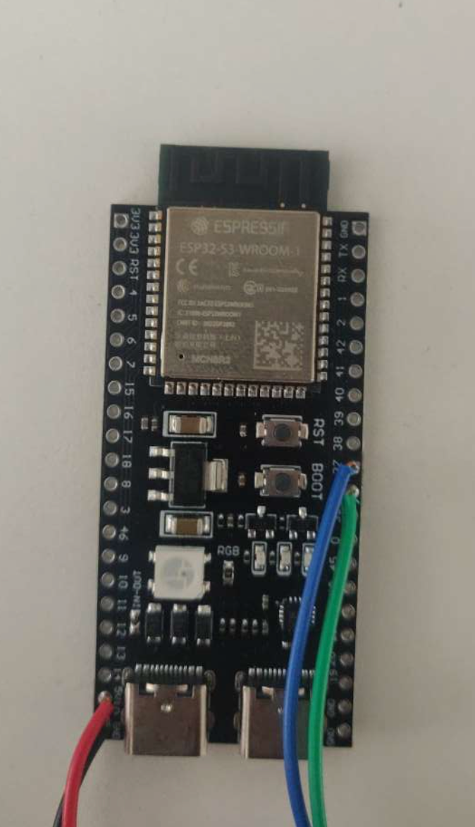

I was using a esp8266 earlier, but now I have started using a ESP32-S3-WROOM-1. My RX and TX pins are on pin 37 and 36 respectively. (PFA image for reference.) I can confirm that the board is working fine but none of the data from the pixhawk is being shown on the serial monitor on arduino ide. I believe the rx and tx pins are the problem. Can someone give me a technique to code using cpp or give me a solution to this problem?

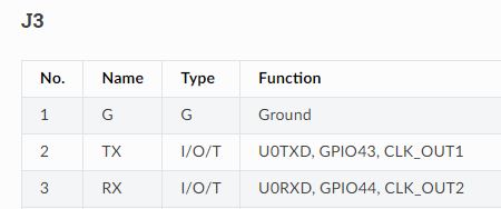

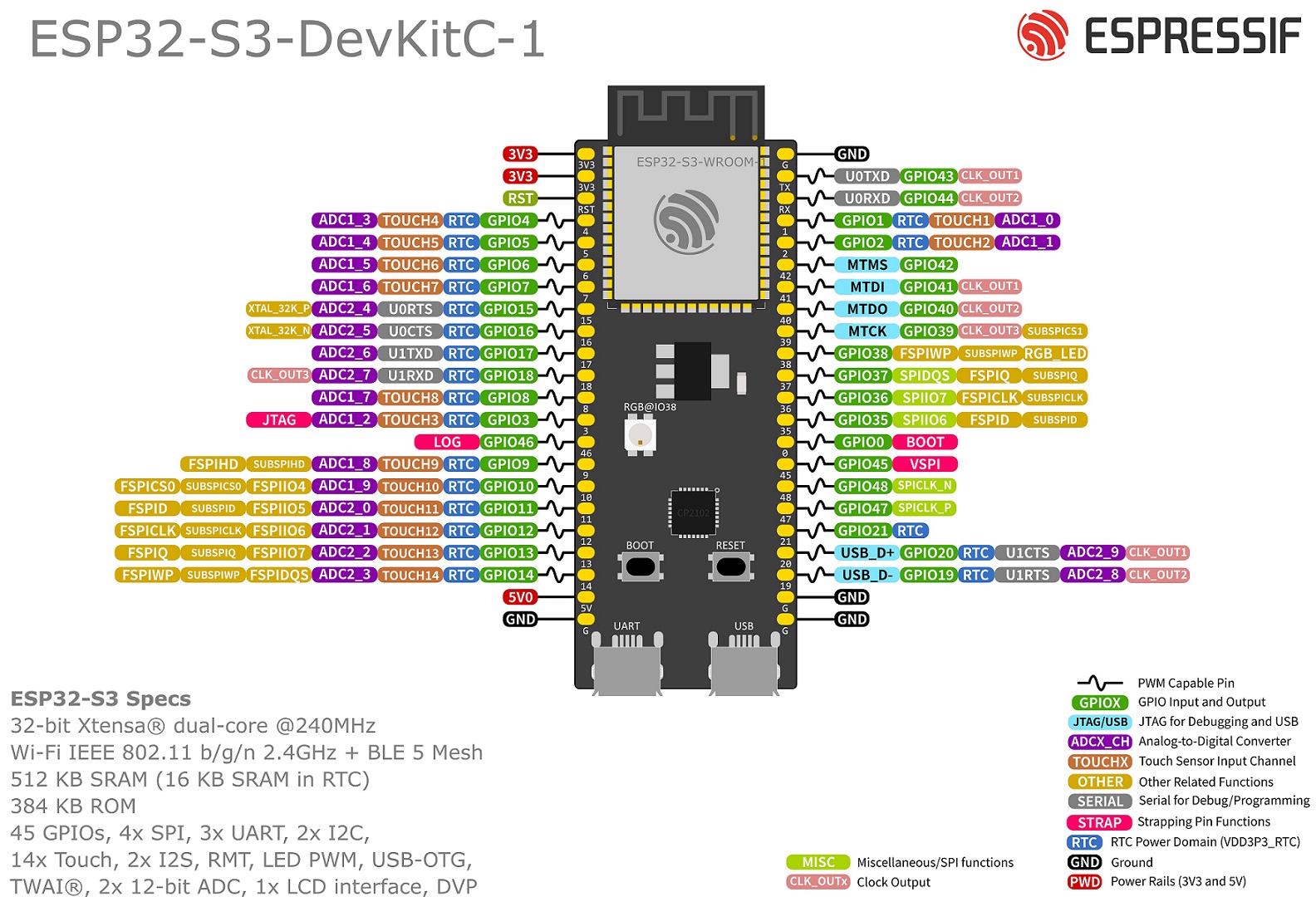

Please inform the name or model of your ESP32 S3 board.
See what is written on your board - TX and RX on the top right side. These are the UART pins.
In the case of the ESP32 S3 DevKit, these pins are used to UART:
ESP32S3 TXD RXD.JPG (13.37 KiB) Viewed 2546 times
https://dl.espressif.com/dl/schematics/ ... 220413.pdf
https://docs.espressif.com/projects/esp ... -reference
https://docs.espressif.com/projects/esp ... t_v1.1.jpg
