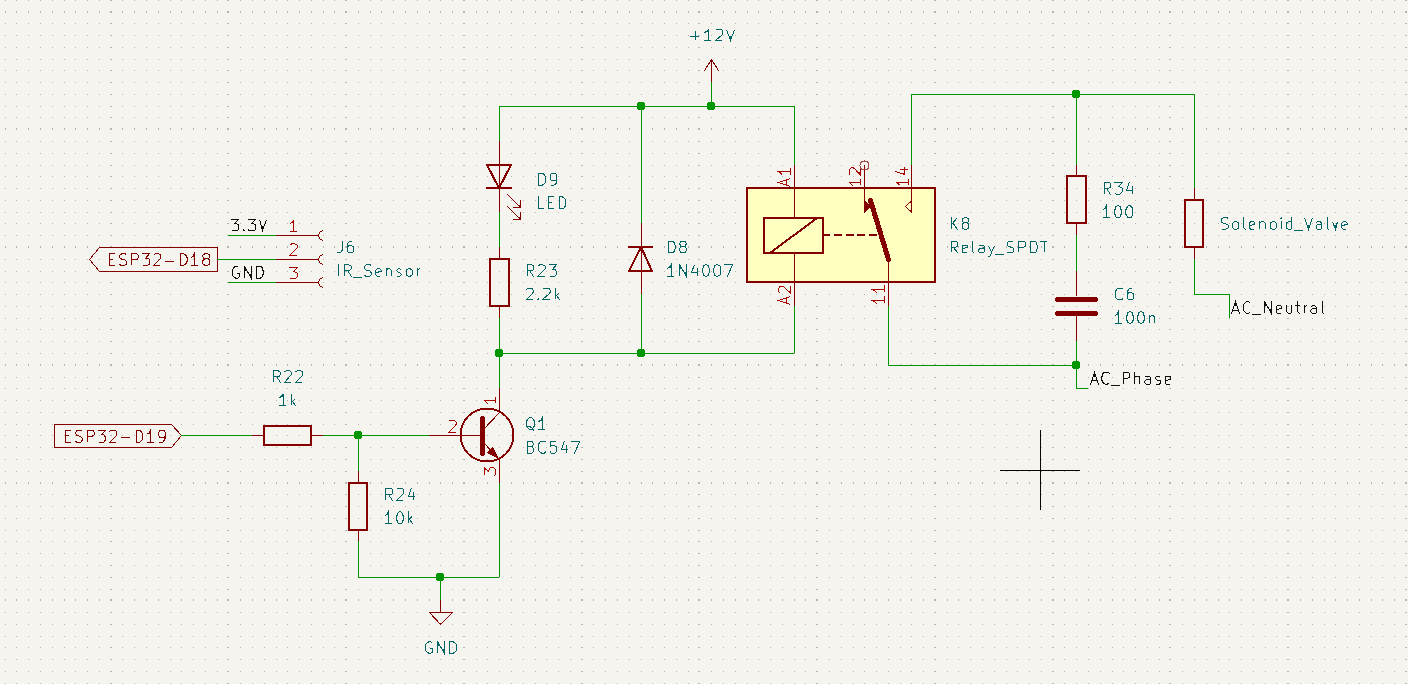

Objective : Switch 240V AC solenoid valve using ESP32.
Hardware Setup : An IR sensor (J6) to detect the input from the user, which in turn switches on a 12V operated relay (K8) via a BC547 transistor (Q1)
Schematic :
Schematic to swtich 240V AC solenoid valve

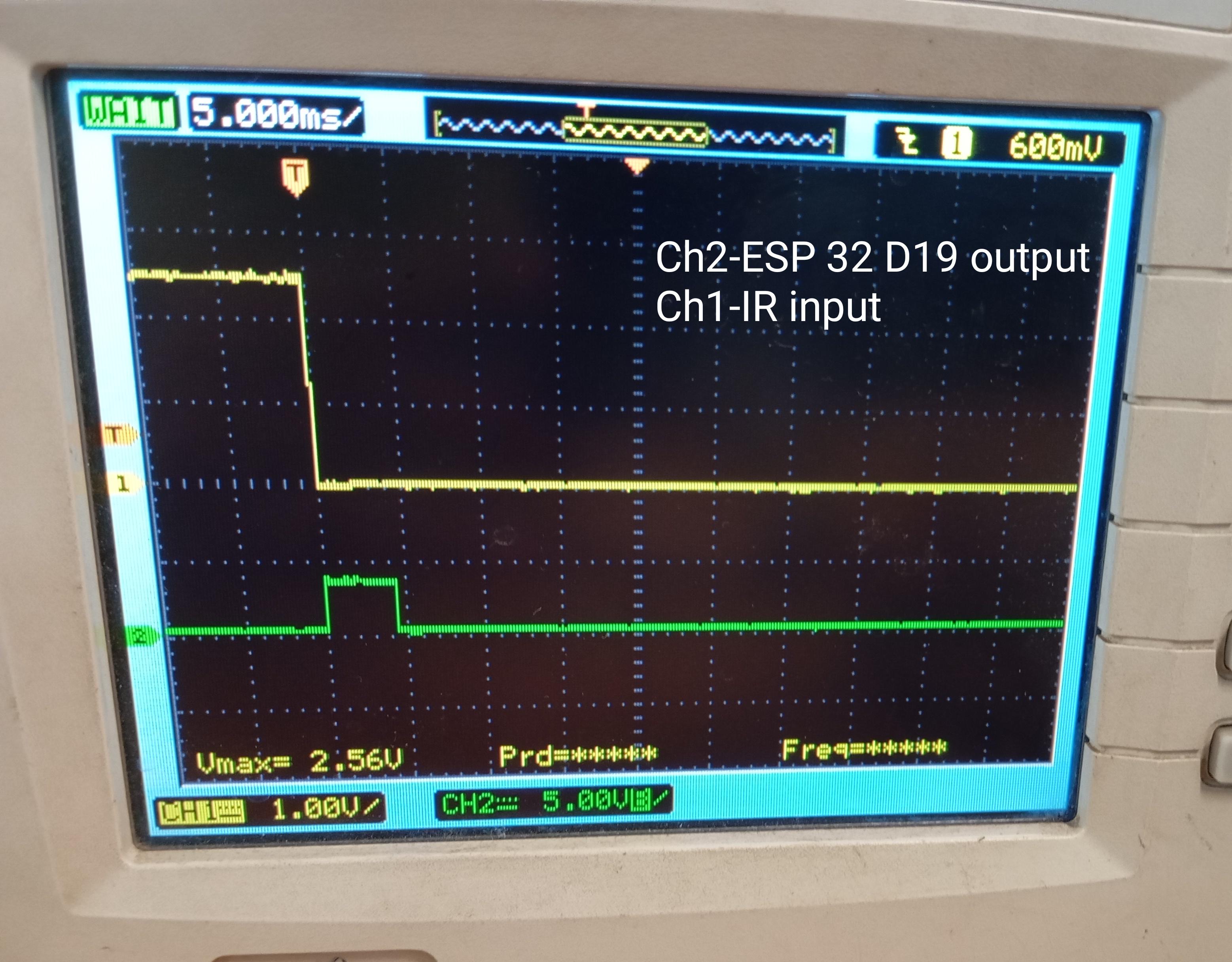

ESP32 is getting false interrupt just after the 240AC solenoid valve is turned ON. This issue occurs 6 out of 10 times, the remaining 4 times, it works as intended. Here is a snapshot from the DSO-
Snapshot of testing on DSO
CH1 is attached to GPIO18 i.e data signal from the IR sensor
CH2 is attached to GPIO19 i.e output signal for the transistor
On receiving the a negative edge, the ESP32 switches on the relay. However, roughly 5ms later, it switches it off as it receives another negative edge interrupt, which is not visible in the DSO.

1. Why and how is the ESP32 receiving a false interrupt specifically when turning on an AC solenoid valve?
2. How can this issue be resolved?

Postby Sprite » Sun Aug 04, 2024 12:46 am
Your relay probably shoots a bunch of ESD noise into the rest of the circuit, triggering the interrupt logic. You could try filtering it out, but I'd personally simply ignore any interrupt that comes too soon after an already-processed interrupt.
