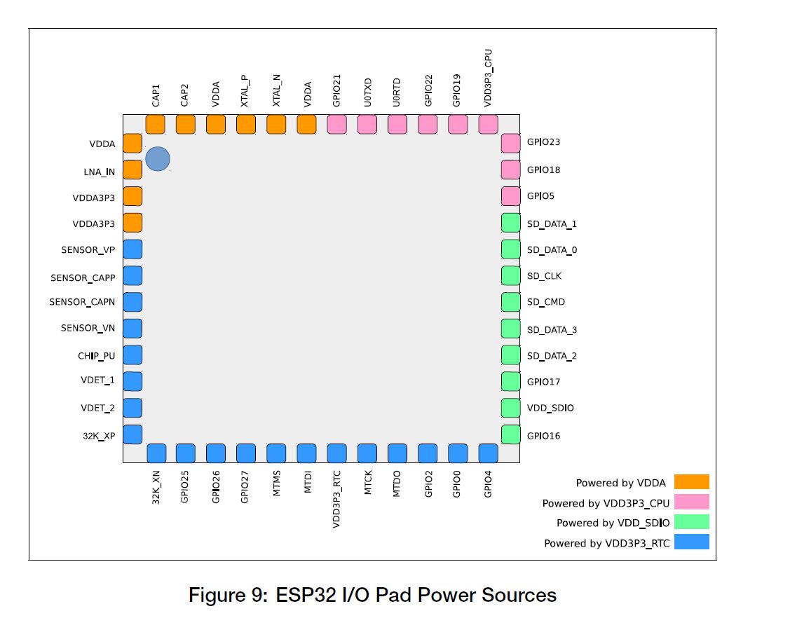

Like other variants of ESP32, ESP32D2WD is rated for supply voltages down to 2.3V.
Only the pins in VDDSDIO power domain of the ESP32D2WD work at 1.8V, the rest of the pins work at 2.3-3.6V.
JTAG pins are not in VDDSDIO power domain, so your JTAG adapter does not need to be 1.8V compatible.

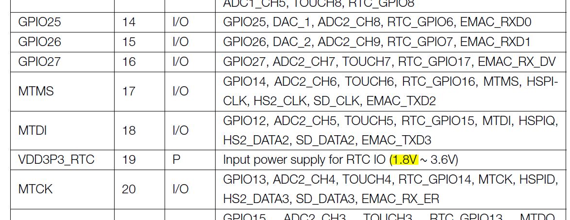

According to the latest ESP32 datasheet, both VDD3P3_CPU & VDD3P3_RTC can be power from 1.8v to 3.6. See attached..
Since the JTAG lines are in RTC domain, they should be 1.8v, if my understanding is correct. I am designing a board with all domains powered at 1.8v (except VDDA at 3.3v). Please Advise!

Oh, apparently I was reading an older version of the datasheet. Sorry for the confusion.
