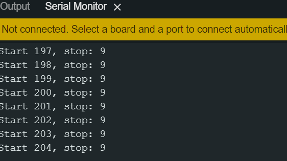

Postby cosminrs » Fri Aug 30, 2024 10:17 am
I have the following situation: I have an implementation of Djikstra's alogorithm that doesn't use queues (core panic as well) that doesn't generate the same result when run on ESP(first code, first image) and PC(seconde code, second image). The pc code replaces serial prints with cout and has a main function that calls setup() and loop(). Other than that copy pasted. Something lets the index value of the front of the queue continue increasing on ESP, but not on Windows. I am very confused
Screenshot 2024-08-30 130950.png (8.25 KiB) Viewed 1638 times
