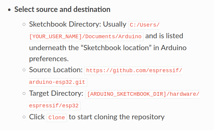

by lbernstone
From manual installation instructions:
Screenshot from 2024-09-20 06-32-23.png (71.36 KiB) Viewed 7693 times

I cloned with git as it states in the docs, I make the c2 not hidden, I can see the new hardware directory show up in Arduino IDE.. however still get the error.
No such file or directory: 'C:\\Users\\Richard\\Documents\\Arduino\\hardware\\espressif\\esp32\\tools\\esp32-arduino-libs\\esp32c2\\bin\\bootloader_qio_60m.elf'
All ESPs are there in C:\Users\Richard\Documents\Arduino\hardware\espressif\esp32\tools\esp32-arduino-libs
see attached image
but no C2
R

Re: Compiling ESP32-C2 Arduino lib
Posted: Tue Sep 24, 2024 4:55 pm
by lbernstone
