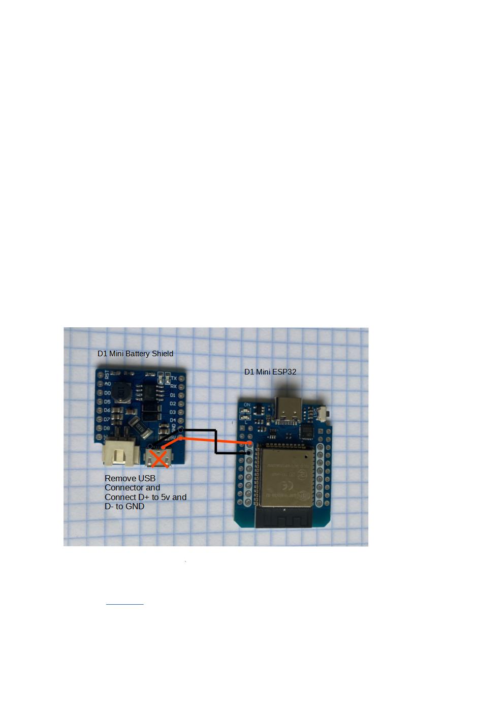

Can anyone see anything wrong with doing the following
Removing the USB connector from the battery shield and connecting VCC(5v) and GND to the USB D+ and D- connectors
Schematically
When the ESP32 is powered from the USB it also provides regulated 5v input to the charger. Without USB power and a battery connected the charger provides the power to the ESP32
ESP32 D1 Mini and Battery Shield
