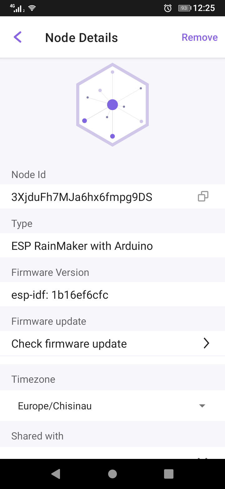

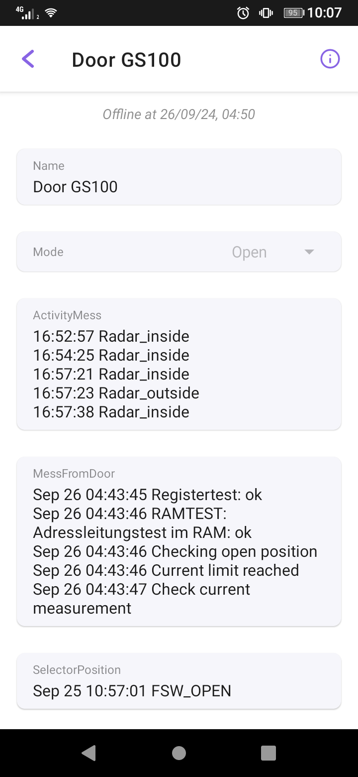

Here is a screenshot from the app.
- Screenshot_20240927-122512.png (79.93 KiB) Viewed 14096 times
- Screenshot_20240927-100748.png (127.97 KiB) Viewed 14096 times
Re: The device suddenly lost access to MQTT
We see that your node id (3XjduFh7MJa6hx6fmpg9DS) is amongst the ones deactivated recently for violating our fair usage policy. You may have to claim new certificates and ensure that the firmware does not send too many messages so that it does not get deactivated again.
