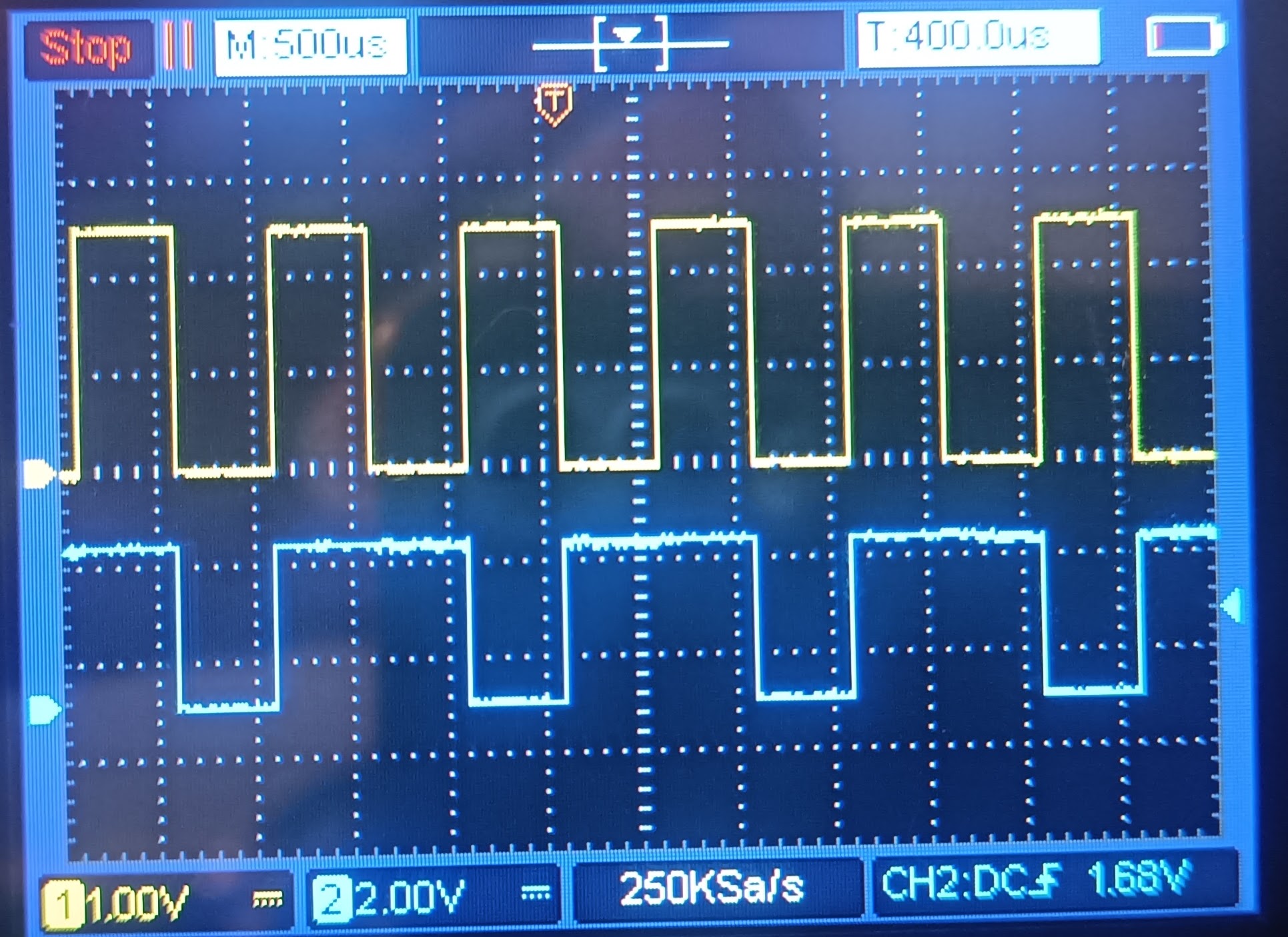

I'm working on a problem encountered with a interrupt handler that should trigger on rising and falling edges on a gpio pin configured as as an input.
The original code appeared to be missing some edges, so I've stripped it down to the bare minimum and wired up the ESP32 to 1kHz square wave generator to try to rule out as many external factors as possible.
Here's the waveform recorded on my scope:
The yellow trace is the 1kHz square wave from the signal generator
The blue trace is from an ESP32 pin configured as an output which should toggle on each edge of the square wave.
For some reason I'm missing 1-3 edges in what appears to be a very regular pattern.
Here's the code (Yes - I know I've programmed the GPIO input and output ports in different ways...)

I've experimented with changing / removing the debounce, and searched for answers - most of which refer to slow rise/fall times on the input signal but I've ruled that out by using the signal generator.
Any suggestions on what I'm doing wrong or how to fix this very much appreciated
Thanks

To capture both edges, use GPIO_INTR_ANYEDGE instead of GPIO_INTR_POSEDGE.
And instead of
if (outputValue++ >1) outputValue=0;
gpio_set_level(OUTPUT_PIN_A,outputValue);
Try
outputValue = outputValue ^ 1;

You're not missing interrupts. Your handler code just doesn't toggle the output pin on one interrupt out of every three.

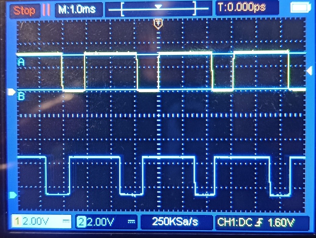

I've managed to get the pulse encoders working, but now I've hit a problem with the (cheap) encoder on the motor I'm using.
Looking at the attached oscilloscope trace
Encoder - Clockwise.jpg (281.43 KiB) Viewed 2747 times
The rising edge on channel A and the falling edge of channel B are nicely aligned with the middle of the high level on the other channel.
However the falling edge on Ch A and the rising edge of Ch B are very close together. This is messing up the pulse counting on some of the motors I have as I cannot guarantee which order the edges occur.

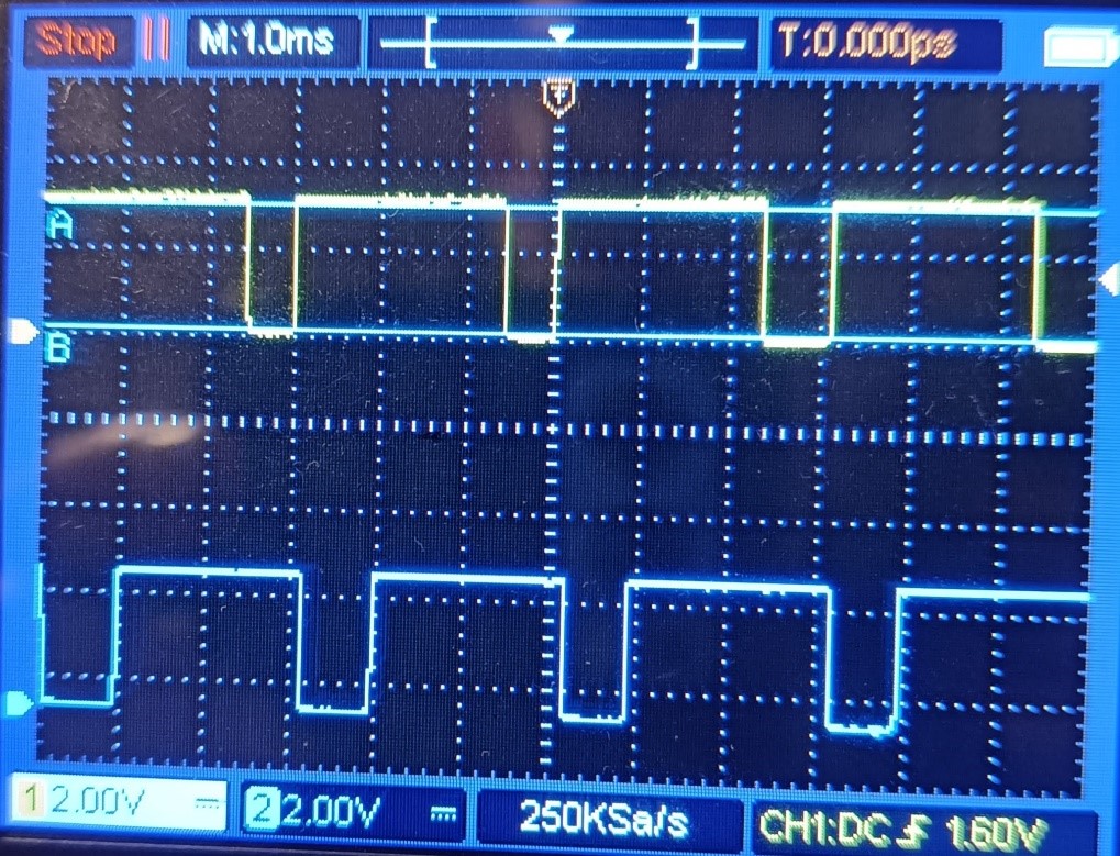

The problem occurs when the motor spins the other way:
Encoder - Anticlockwise.jpg (290.7 KiB) Viewed 2747 times
Now it's the falling edge of Ch B and the rising edge of Ch A that are aligned.
I can't see a way to handle this using the ESP32 pulse count module.
Previous attempts to use interrupts failed as the interrupts were missed.
I'm open to any suggestions!

MicroController
Posts: 2661
Location: Europe, Germany
Re: ESP32 GPIO Interrupts Missing
Postby MicroController » Sat Nov 09, 2024 11:24 pm
I think the PCNT hardware should actually be able to discern the couple of microseconds which appear to still be there between the edges of A and B. (Haven't found definitive info though, only that it's clocked from the APB clock @ 80MHz default.)
What's the actual shortest time you see between the A and B edges?
Maybe the signals' rise/fall times are too slow, and/or there's a bit of noise, and/or some bouncing, causing multiple edges to be detected where there's actually only one.
You can try fiddling with the PCNT's glitch filter, or try e.g. using a Schmitt trigger.
