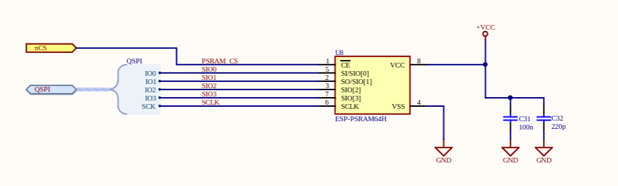

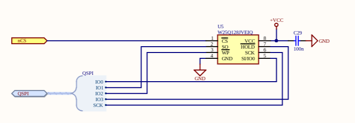

We are developing a custom board with ESP32-S3-WROOM-1U 16R8 module with an
additional external ESP-PSRAM64 and a Winbond 25Q128 SPI FLASH.
However in the first prototypes there is a problem with initialization of the external flash, we test it by running an ESP-IDF example https://github.com/espressif/esp-idf/tr ... lash_fatfs. So far we tried ESP-IDF 4.47 and 5.3.1 and the error occurs on both versions.

PSRAM and SPIFLASH are both connected on the SPI2 (host id = 1) bus to the following IO pins. The list also includes other used pins:
PSRAM_CS(SPI2_CS0)     IO10
FLASH_CS(SPI2_CS1)     IO8
SPI2_CLK               IO12
SPI2_SIO0 (SI)         IO11
SPI2_SIO1 (SO)         IO13
SPI2_SIO2 (WP)         IO14
SPI2_SIO3 (HOLD)       IO9
TX BG77   IO16
RX BG77    IO17
PWRKEY       IO15
SW1             IO1
TX MSP430 IO6
RX MSP430  IO7
LED GREEN    IO47
LED1 ORANGE  IO48
TPM SDA      IO39
TPM SCL      IO40
MSP_EVENT    IO5
MSP_PWRFAIL  IO4
USB D- TP1   IO19
USB D+ TP4   IO20
The external PSRAM works fine, it is initialized and added to the memory pool, although it must be set to run in octal mode(?) in the menuconfig. We also tried to disable it in the menuconfig.
SPI FLASH connection diagram
Screenshot from 2024-10-21 18-01-20.png (18.61 KiB) Viewed 2707 times
PSRAM connection diagram
Screenshot from 2024-10-21 18-02-35.png (24.25 KiB) Viewed 2707 times

Postby Sprite » Wed Oct 23, 2024 1:14 am
That module has 8MiB of psram internally (which probably is octal psram, hence you need to select that). Your project doesn't use the external psram at all.
I am not sure why the external flash isn't detected, but if it's on the same qspi bus as the (uninitialized) psram, perhaps the psram interferes. I'd suggest removing that (or manually setting its CS pin high) and seeing if that solves the issue.

We found that setting the PSRAM CS pin to HIGH solved the issue and now we are able to use the external flash properly. :)
The reason for this was that all the time we initialized and used only the internal PSRAM in the ESP32-S3-WROOM-1U module (SPI1), not the one we connected to SPI2, which was interfering with our FLASH.
It seems that there is no support for having two PSRAMS running simultaneously (SPI1 and SPI2). :oops: But you can prove me wrong.
