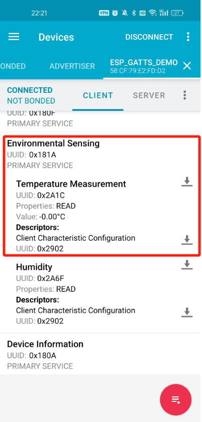

Hardware (BLE server): ESP32-C3-DevKitM-1
Mobile App (BLE client): nRF Connect
Example code: Gatt_Server_Service_Table
I would like to BLE standard Environmental Sensing Service (ESS 0x181A), Temperature Measurement Characteristic (0x2A1C)
How to send the temperature float value such as 25.63℃ in the correct format? If I use uint8_t ess_temperature[] = {0x00, 0x03, 0x0A, 0x00,0x00}; It will show 2563.00℃, but I want to show 25.63℃.

But on nRF Connect App in mobile phone, it shows the result is -0.00℃. How to send the temperature float value such as 25.6℃ in the correct format?

You need to send in P2 format: 25.6 * 100 = 2560.
int16_t value = htole16(2560);
int error = os_mbuf_append(ctx->om, &value, sizeof value);
