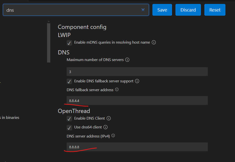

Hello everyone, I have my Thread network with Espressif devices and I can ping perfectly to the internet using the IP (ping 8.8.8.8), but I would like to know what I need to configure in my environment for ping to a URL/Domain to work (ping google.com)??

You can use public DNS servers like Google DNS (8.8.8.8 or 8.8.4.4) or Cloudflare DNS (1.1.1.1).

thanks for helping aliarifat794.. So, I've already set Google DNS on my threads devices, but I still can't get name resolution when using "ping google.com", I only get the response using "ping 8.8.8.8"..
image below of the configuration made in menuconfig:
