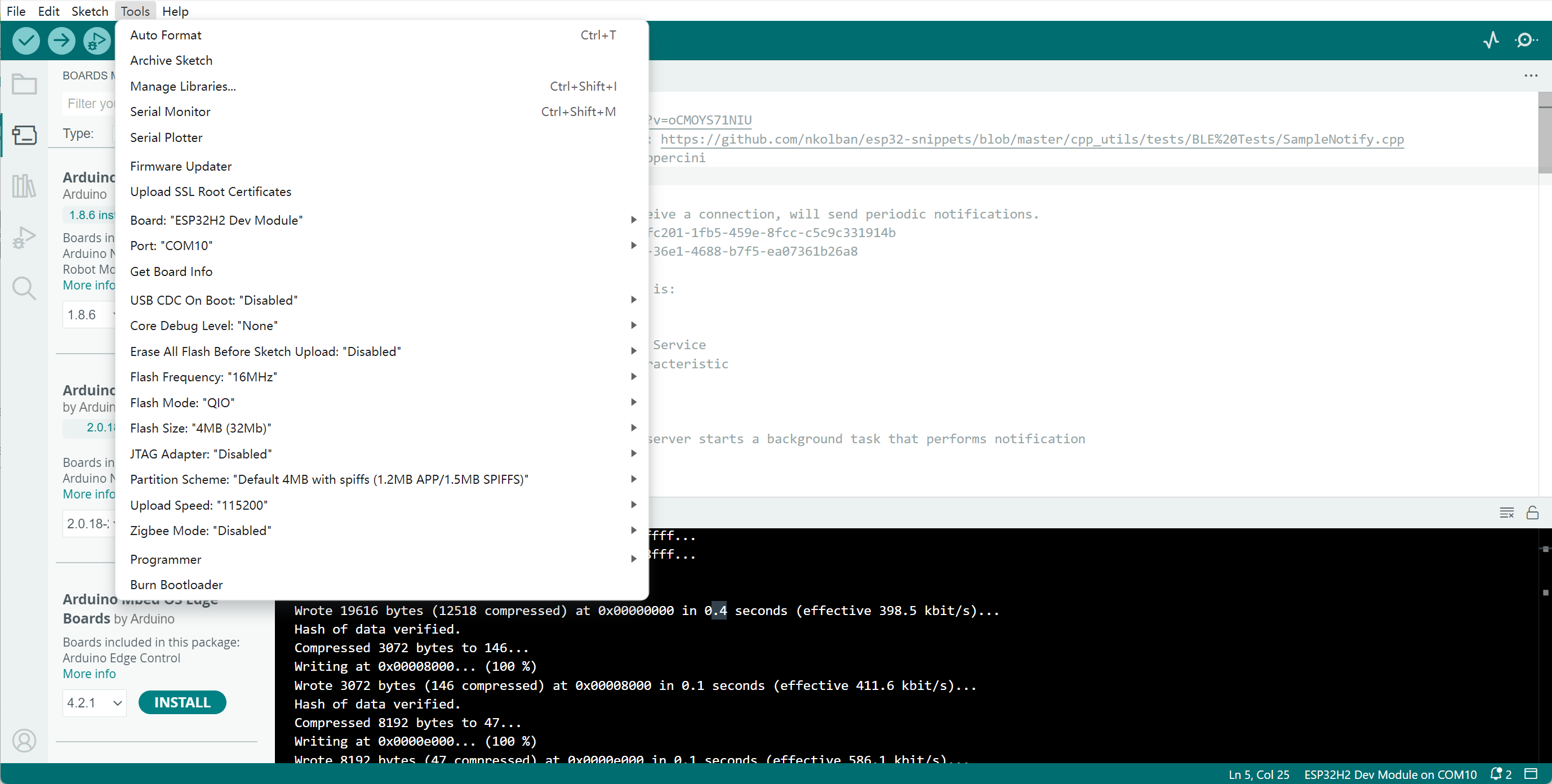

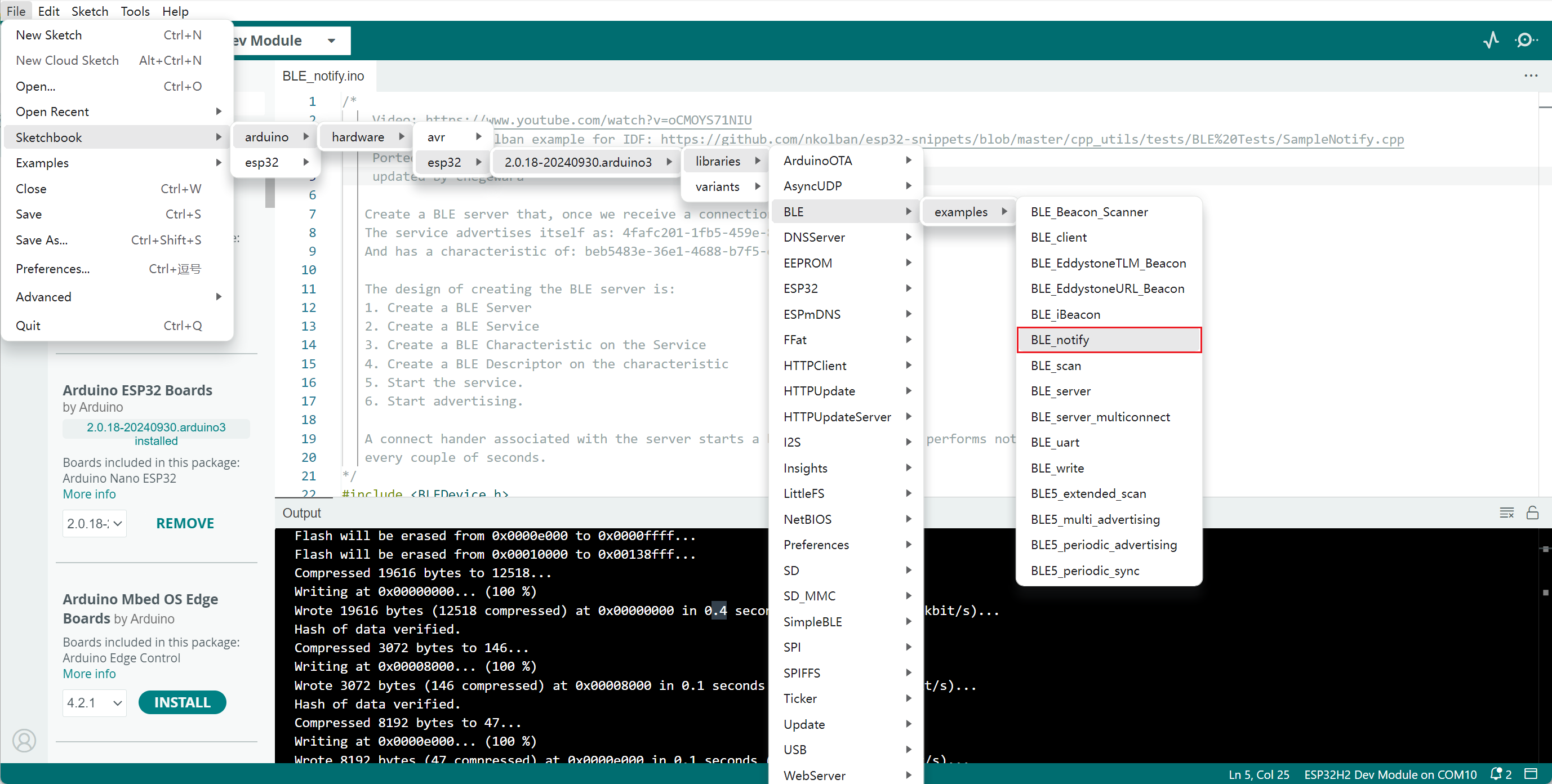

ESP32H2 can be upload in Arduino IDE but Unable to find in the BLE Scanner,I use the official routine(up-to-date),
my settings are as follows
the upload result is as follows:

but I cannot find in the BLE Scanner ,Did I miss a crucial step?

Postby lbernstone » Sun Nov 17, 2024 9:25 am
Make sure you are using the latest version (3.0.7) and using the matching Scan sketch.
I'd also recommend you use the NimBLE library rather than the included bluedroid.
If you need additional help, you will need to access the serial log, and set core debug level to verbose. It is difficult to troubleshoot without some output.
