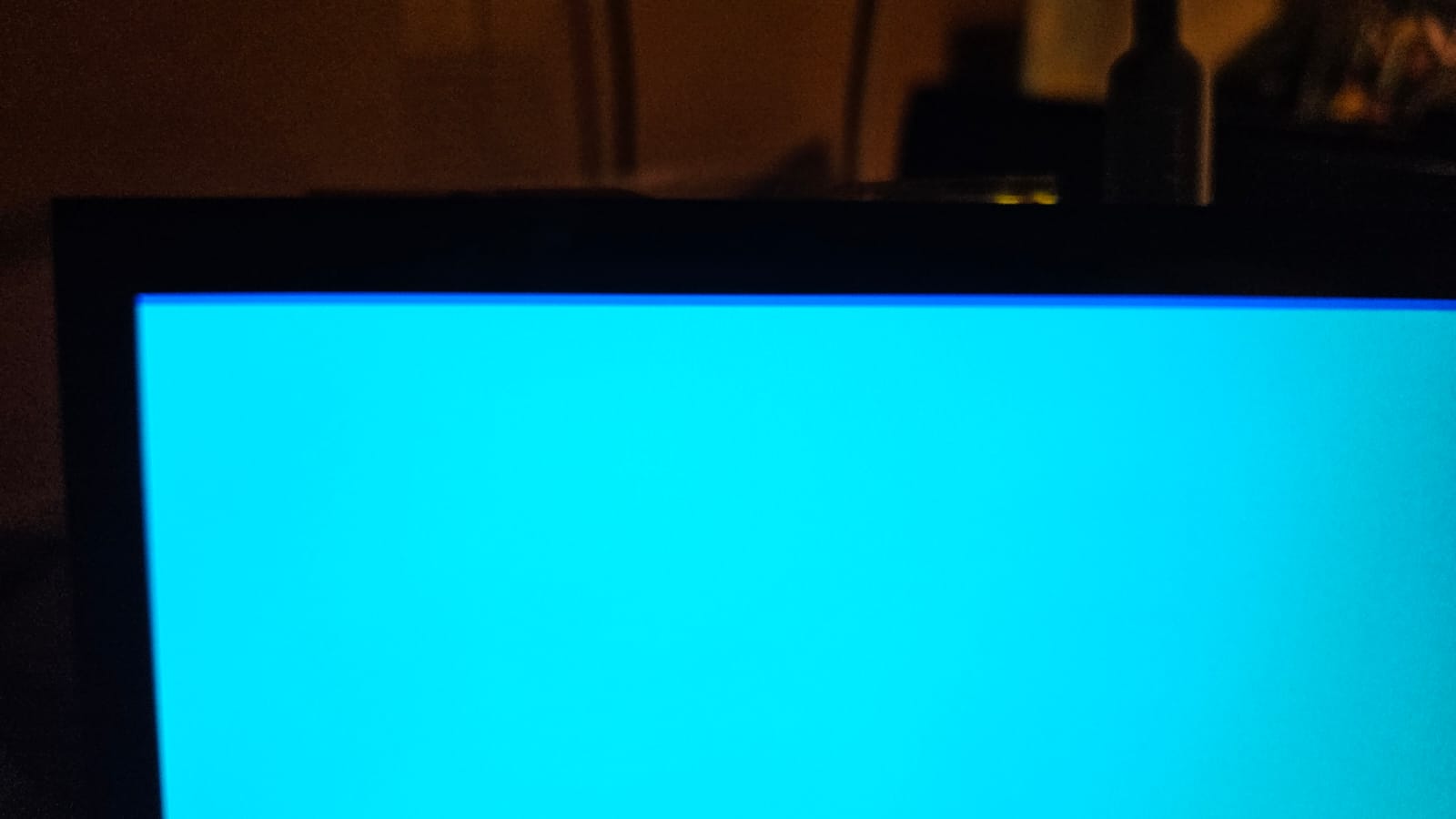

Hi! :D I want to make a simple code where the screen goes to red, green and blue in a loop to practice.
But I don't find how to make it work.

I believe I am doing the same that you, mine is a bit different,
static void test_draw_color (esp_lcd_panel_handle_t * panel_handle, uint16_t h_res, uint16_t v_res)
    uint16_t *color = (uint16_t *) heap_caps_calloc (1, h_res * v_res, MALLOC_CAP_DMA);
    if (color == NULL)
        ESP_LOGE(TAG, "Color not initialized");
        return;
    ESP_LOGI(TAG, "We are entering the loop.");
    while (true)
        // Draw Red
        memset (color, RED, h_res * v_res); // Fill with red
        esp_lcd_panel_draw_bitmap (panel_handle, 10, 0, h_res + 10, v_res, color);
        xSemaphoreTake (refresh_finish, portMAX_DELAY);
        memset (color, GREEN, h_res * v_res); // Fill with green
        memset (color, BLUE, h_res * v_res); // Fill with blue
        vTaskDelay(1);
    free(color);
None of the colors are represented.

As for the coloring part, I am now doing this:
test_draw_color_pattern(mipi_dpi_panel, 1024, 600);
static void test_draw_color_pattern (esp_lcd_panel_handle_t * panel_handle, uint16_t h_res, uint16_t v_res)
    size_t total_size = h_res * v_res * sizeof(uint16_t);
    size_t total_pixels = h_res * v_res;
    uint16_t *color = NULL;
    esp_lcd_dpi_panel_get_frame_buffer(panel_handle, 1, &color);
    ESP_LOGI(TAG, "color size %zu", total_size);
    if (color == NULL)
        return;
    ESP_LOGI(TAG, "Vamos a entrar en el bucle");

However, for some reason, I am only able to change about 10 rows of pixels—only the upper part—and in that part, it flickers a lot.
Thanks for the help!
Posts: 10639
Re: How to draw in the EK79007 for the esp32-p4 dev kit
Postby Sprite » Sun Nov 24, 2024 5:56 am
THat blue-ish color on the rest of the screen is the mipi peripheral not getting its data fast enough... I'm thinking your PSRAM may be at 20MHz. Can you try running menuconfig, then enabling experimental features (if it's not already), then setting psram speed to 200MHz?

Thanks a lot! It worked!
