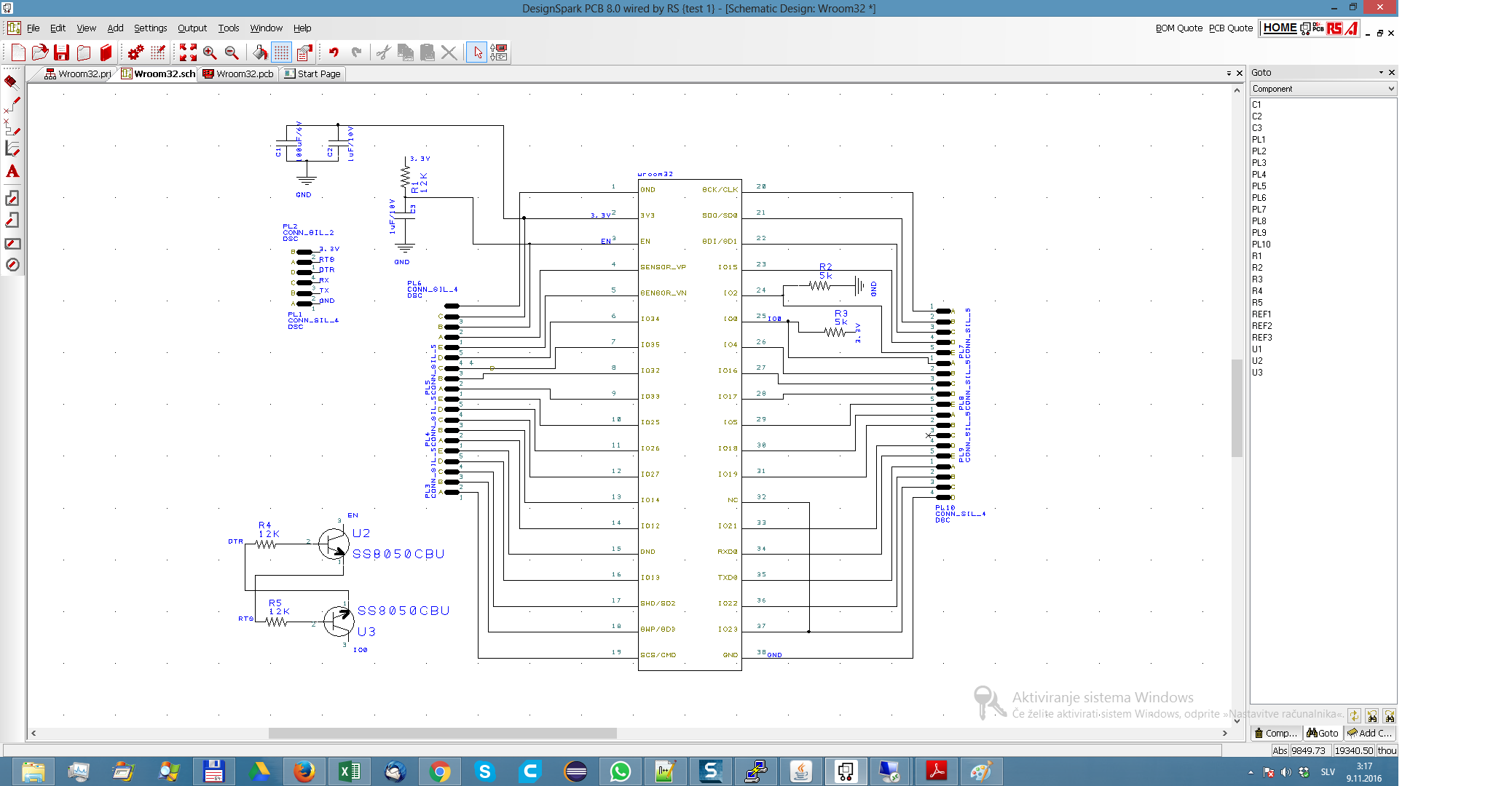

I am trying to design minimalistic custom board that would allow flashing without reset and flash buttons. I tried to follow following instructions https://gist.github.com/morganrallen/09 ... 9c2a621d50
I plan to flash upload firmware with usb to ttl serial from ebay like here:
http://www.ebay.com/itm/381292739186?_t ... EBIDX%3AIT
@morganrallen is connecting this pins dtr and rts directly but devc from espressif (https://dl.espressif.com/dl/schematics/ ... V2_sch.pdf) is using NPN transistors.
So I wonder are this NPN transistors for DTR (mark as U2 on schematic) and CTS (mark as U3 on schematic) lines necessary?

The transistors are for the case where both DTR & RTS are asserted together. When either RTS or DTS are asserted (goes low) it still pulls EN or GPIO0 (respectively) low, the same if they were wired directly. However if both are asserted at the same time, neither pin is pulled low. There's a little logic truth table in the schematic that shows this.
The reason for wanting this behaviour is that many common serial terminal programs will assert DTR & RTS by default. If you have these wired directly, it will permanently hold the chip in reset unless you reconfigure the serial program not to assert RTS.
This design was first popularised with the NodeMCU board for ESP8266.

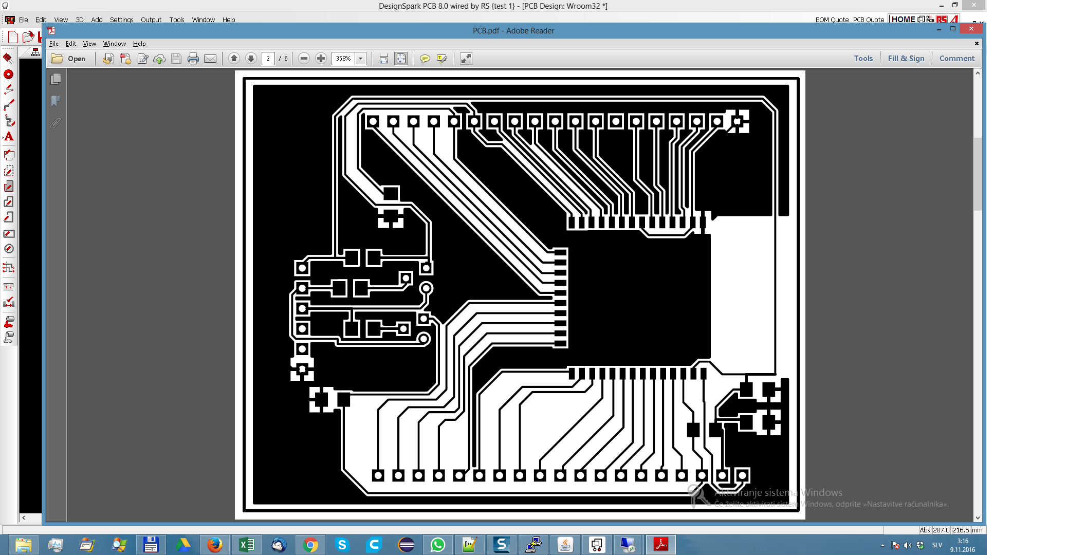

Another question: traces under wroom32 antena traces - would the way I put traces around this area not disturb wifi signal?

This is generally a bad idea. You should keep your traces away from the antenna keep-out area. If possible, I'd also recommend pulling back the ground plane from the end of the board and moving the two SMD components in the bottom right away from the antenna, as much as you can.Another question: traces under wroom32 antena traces - would the way I put traces around this area not disturb wifi signal?

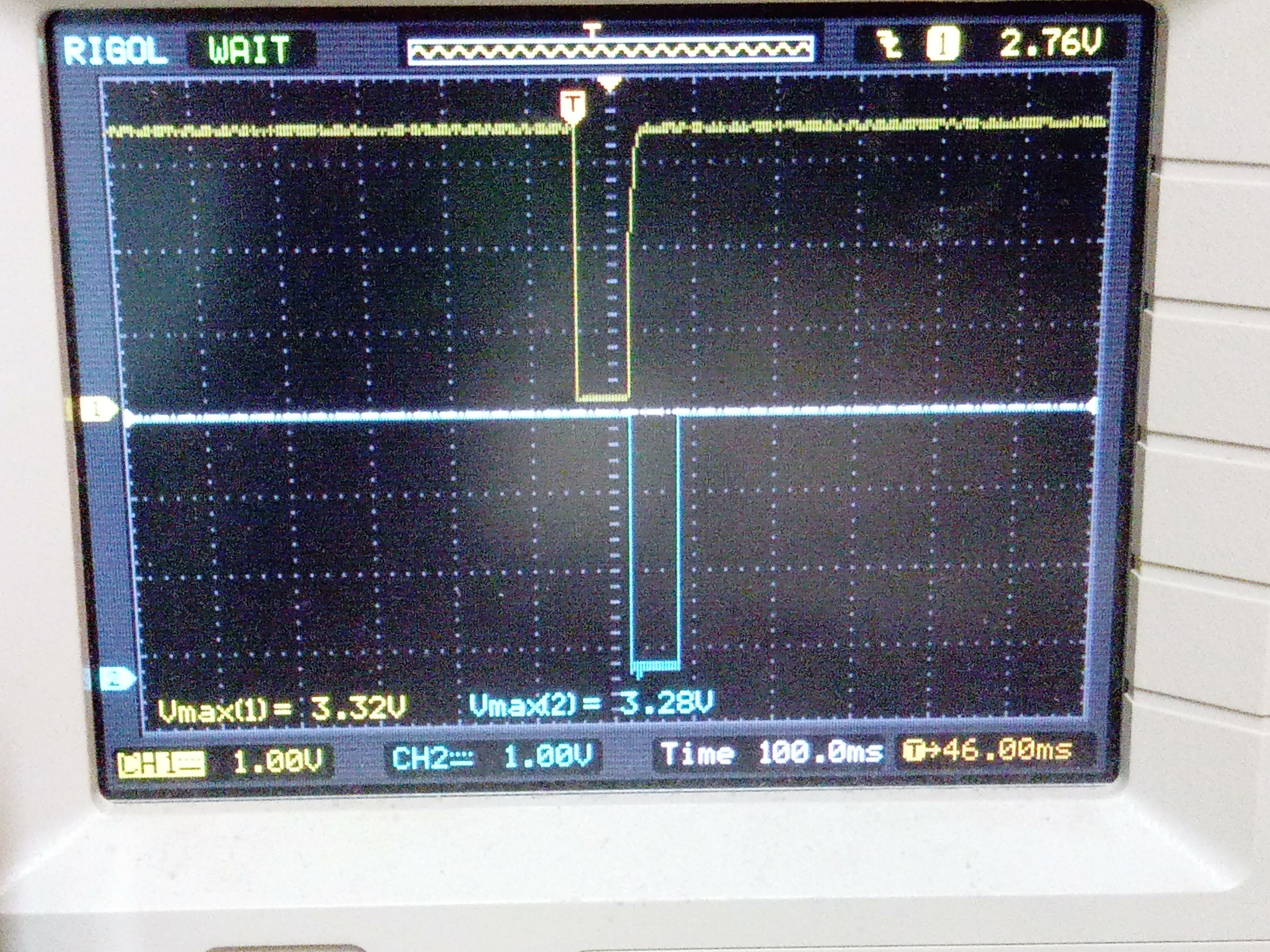

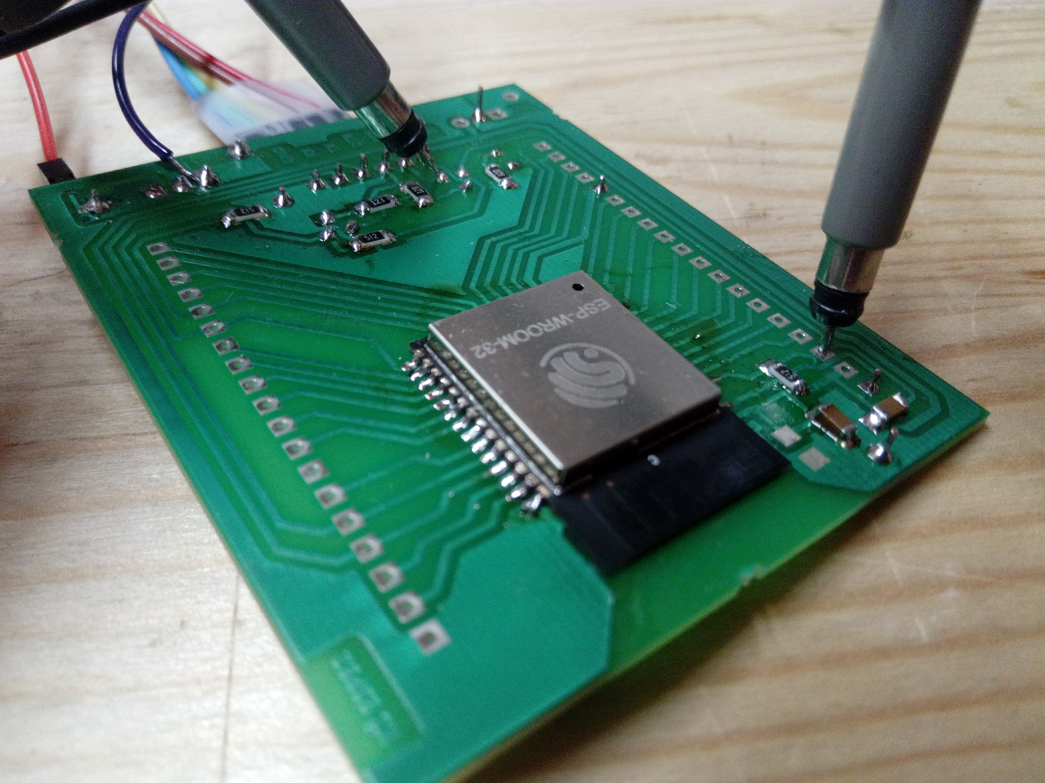

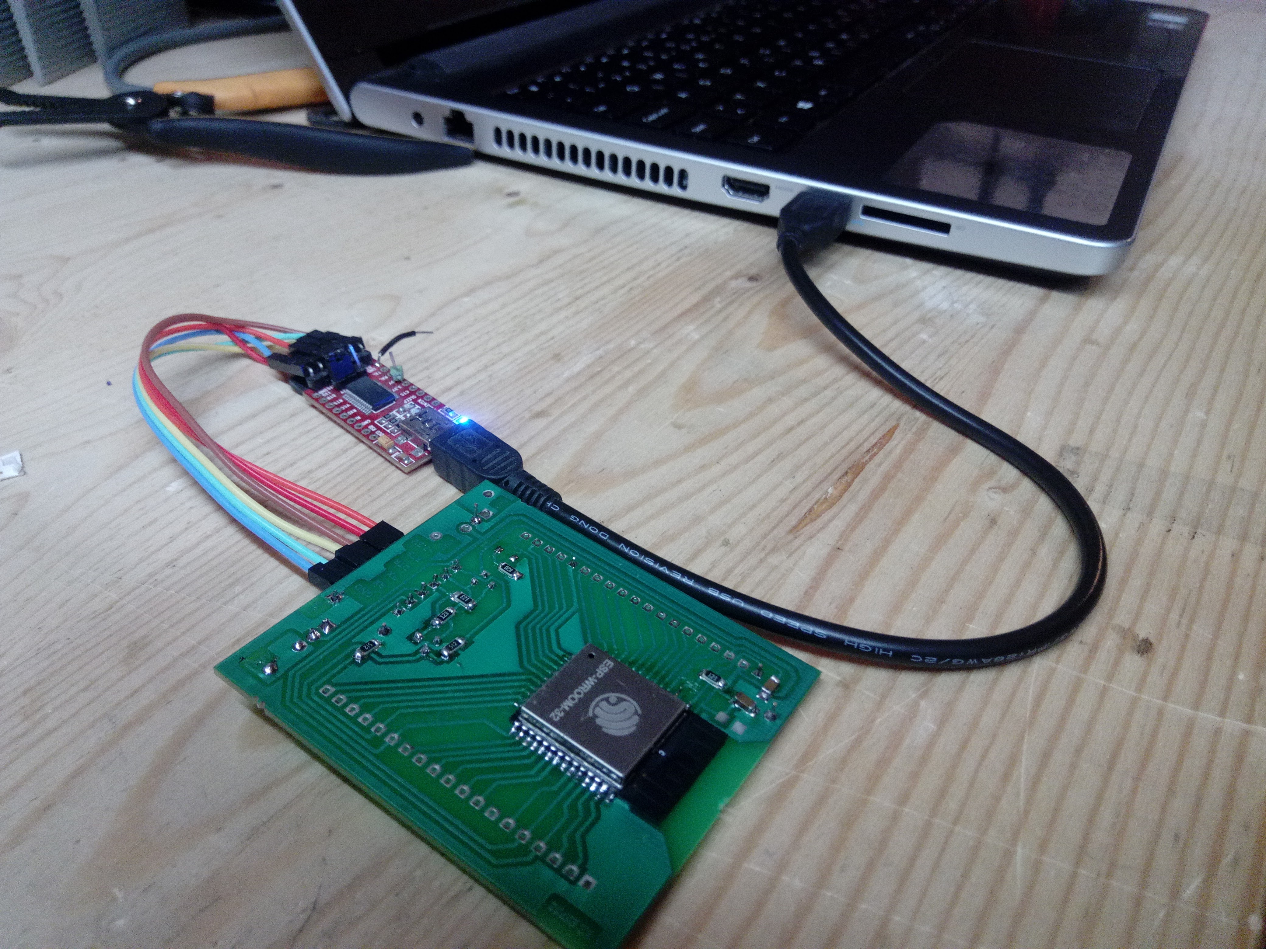

OK, after all I decided to use NPN transistors, but have problem with flashing esp32.
It seems that EN line does not fully transition from 3.3V to 0V (check scope screenshot of yellow line that represents EN). However blue line that represents IO0 does a full transition from 3.3V to 0V - so any idea what could be wrong with my schematics?
Could S8050 NPN transistor for EN line be non operational?? What else could pull EN so strong to 3.3V that it doesn't let go to 0V as IO0 does?
Check also my other attached pictures...

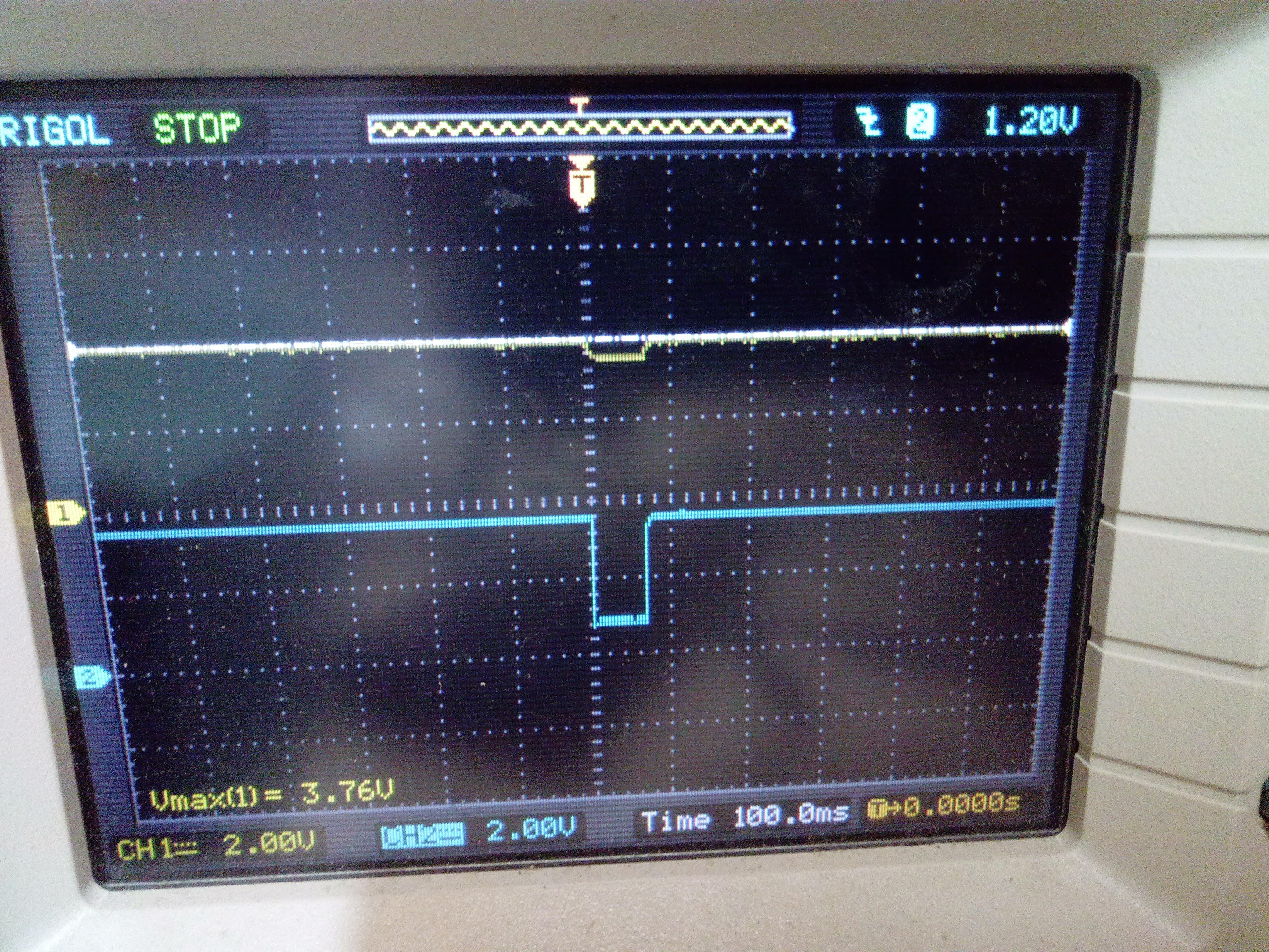

Turned out I had faulty usb - serial ttl adapter.
I picked new one and here is scope trace of io0 and en line: and result from arduino ide:
So thanks for support guys and looking forward for esp32 arduino core functions!
