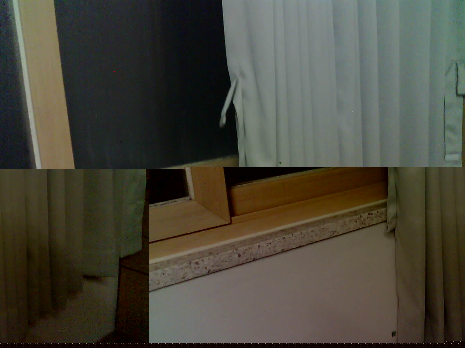

Hello forum,
I am trying to host a web server that returns the captured camera image, but the downloaded image shows weird artifacts.
The top half is normal, but the bottom half look like it is being overwritten or half written, with offset images and weird color banding.
I checked if PSRAM is insufficient, but there were plenty left.
Any help will be appreciated:)
The code is as following:

You can reduce Frame Size. High resolutions like FRAMESIZE_UXGA (1600x1200) consume significant memory. Lower the frame size to reduce strain:
config.frame_size = FRAMESIZE_SXGA; // or FRAMESIZE_XGA
You can reduce the buffer count if two frame buffers are too demanding:
config.fb_count = 1;

mclabman
Joined: Wed May 21, 2025 7:21 pm
Re: ESP-CAM image shows artifacts.
Postby mclabman » Wed May 21, 2025 7:44 pm
I suppose it happens because async web server send image data after camera buffer released. After image request handler.
Camera driver fills the buffer with new data at that moment.
Right way is release the camera buffer after data really sent, at response completion. But I do not know how to get that event.
So easy and wrong way is to copy image data into static buffer, then send it.
Problem is to define size of the buffer and it can not be greater 65535, and next request may corrupt it.
static uint8_t buffer[65535];
