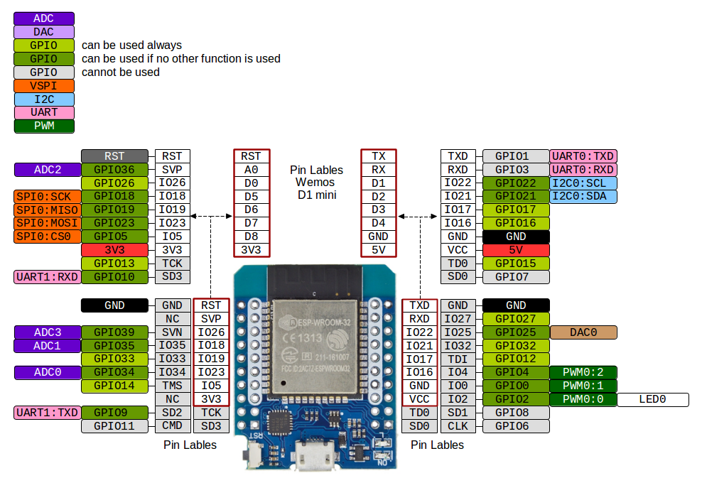

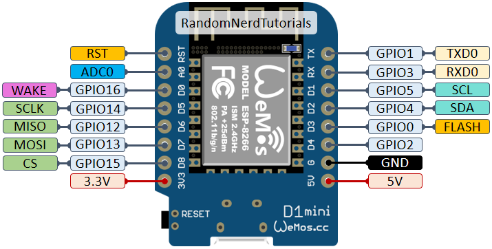

FYI, according to the following image, D2 is GPIO4, which should be referred to as 4 in code, but I am not certain.
However, the Arduino documentation does not claim to support INPUT_PULLDOWN.
https://docs.arduino.cc/language-refere ... o/pinMode/

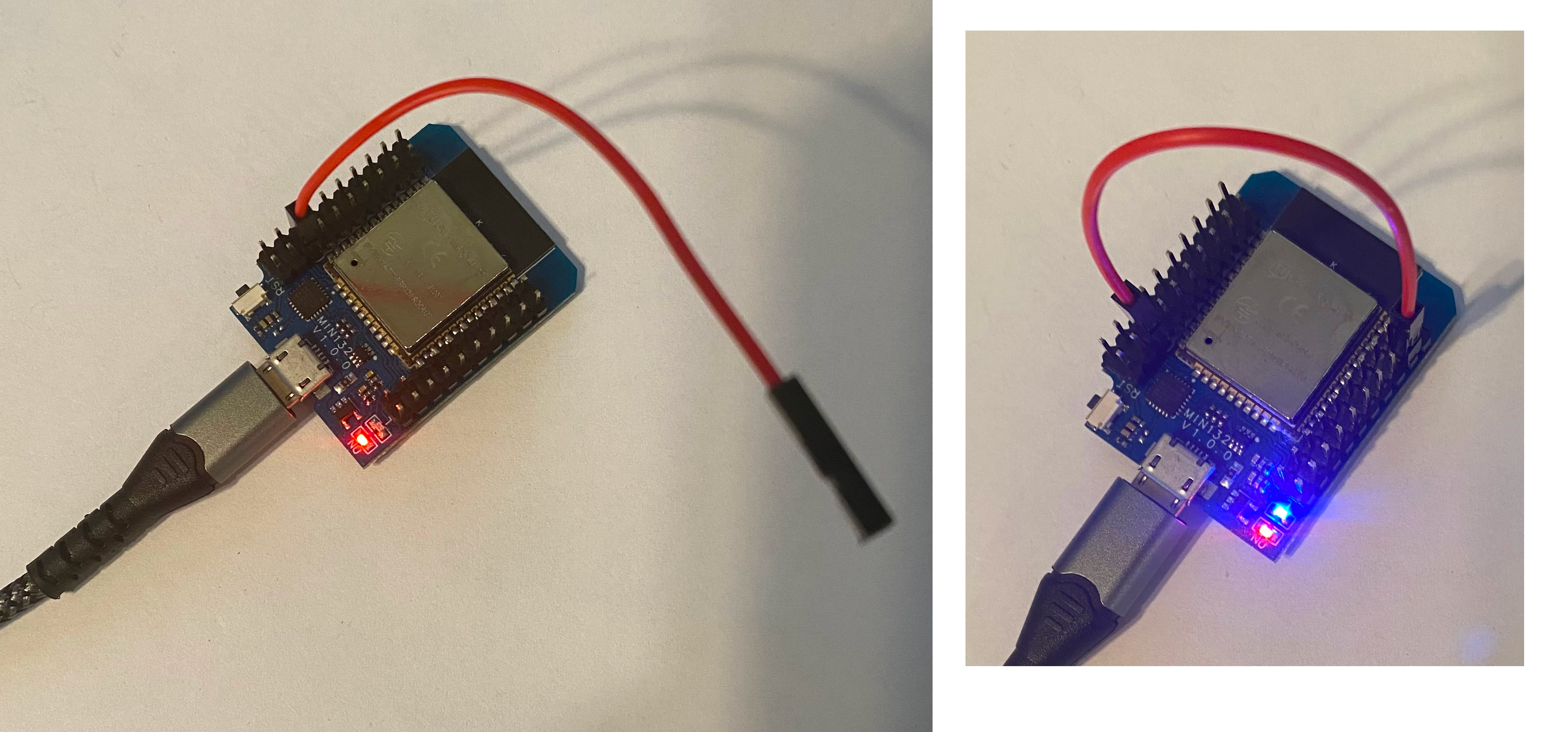

Lastly, I have a WROOM D1 Mini (it is close to a Wemos D1 Mini), and used the following code to get it to work:
Here is the pinout:
All I did was use a Dupont Female-Female Jumper between 3.3V and GPIO27 to "toggle" the onboard LED.
For reference, I changed the input pin mode to just INPUT, and when I removed the jumper wire, the pin "floated" until the voltage fell below the digital pin threshold. This caused the LED to flicker and "die". It makes for an interesting effect, but terrible as a user interface.
Hope this helps.
