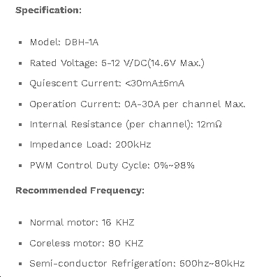

I have a project developed using the Arduino IDE and an Arduino Nano to drive motors on an ROV. This code has been working for a couple of years in various versions. I now need to upgrade to an ESP32-WROOM-32 and, to drive the motors, have delved into the latest mcpwm API. It's taken my brain cell a while to figure it out but I have successfully got the ESP32 to output exactly the PWM I needed - 16kHz PWM with 1024 steps - and I can see this on my scope AND it worked with the new H-Bridge devices (DBH-12V) which I have.
However, after porting the rest of the Arduino Nano code over into my working mcpwm code I checked back and I now have no PWM output at all shown on the scope. Backtracking to just the mcpwm code to try and identify the reason hasn't worked - still no PWM signal. I've also now tested the same ESP32 with ESPHome, trying to output a PWM signal, and again, nothing. I've tried my code on a second ESP32 (which I also used during the porting) but nothing there either.
I can get the same pin to blink an LED both directly and using ESPHome but using ESPHome PWM also does not work.
I've attached the code below but maybe there is a "problem" with the ESP32s which is stopping this from working - I suspect that, during the porting of the remaining Arduino code, I've either damaged something or turned something off inadvertently on both devices.
I would be very grateful for any guidance or suggestions.
Thanks
Andy

// We need the folowing for the DBH-12V H-Bridge...
//   PWM frequency of 16kHz
//   Duty Cycle in steps of 100 - MAX 98% though so limit at 95% for extra safety
//   PWM outputs from each Operator are symmetric but independent
//   Use the same timer for both Operators - MCPWM_UNIT_0
#define PWM_FREQUENCY0 16384
#define PWM_DUTY_STEPS0 950   // Period of each step = 1/PWM_FREQUENCY0 (approx 61us @ 16kHz)

My DBH-12V H-Bridge specifies a "normal" motor frequency of 16kHz (see image below) and I should really have period_ticks at 1024 and use 1000 as the max duty cycle.
If that means I need 1024/resolution_hz = 16384Hz it makes resolution_hz around 16MHz? That sounds way too high as the H-Bridge also specifies 80kHz for a coreless motor which would mean a resolution_hz of 77MHz! The PWM frequency on an Arduino Nano I found quoted at around 500Hz which would give a resolution_hz of around 475kHz which sounds more reasonable. Either way I'm not sure where the 16kHz H-Bridge requirement fits in?
