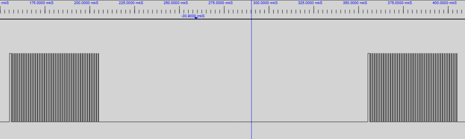

Re: Start a SPI DMA transmission by GPIO trigger ? - ESP32-S3 Forum
.duty_cycle = 30, // 30% duty cycle
.duty_cycle = 0.3, // 30% duty cycle
Perfect, the carrier filling works now! Thank you! I'm adding my project main file. The GPIO 5 works now as sync for three PWM signals generated on GPIO 0, GPIO2 and GPIO 4. Signal on GPIO 0 is carrier filled (could be used as SCLK for SPI) and signal on GPIO 2 or 4 could be used as CS for SPI.
Could I ask how to now configure the triggering of PWM using the falling edge of DRDY? Or is the synchronization (GPIO 5) supposed to serve as a triggering mechanism for the SPI transfer, and the PWM high level should be sufficiently long to prevent another activation of CS between two DRDY signals?
