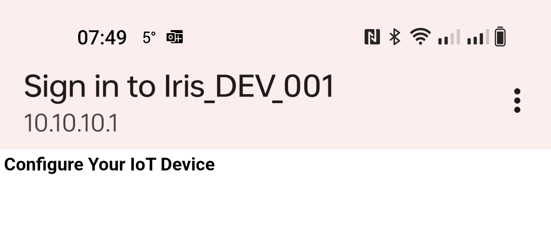

boarchuz
Posts: 656
Re: Landing Page for IoT application / Avoid captive portal
Postby boarchuz » Mon Jan 20, 2025 5:40 am
Can you share an image of this banner? It's likely a function of the device OS and there's nothing you will be able to do on the ESP32 side to hide it.
BivvyCoder
Posts: 25
Joined: Sun Jan 28, 2024 5:20 pm
Postby BivvyCoder » Tue Jan 21, 2025 7:55 am
I suspected that might be the problem.
Here's the banner on my Android phone
mersin_jr
