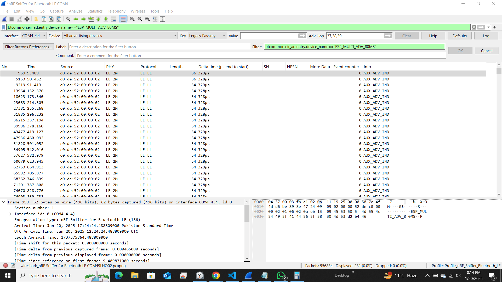

Large Interval Clamped
If I do not stop extended advertising, I set .interval_min = 0x1FFFF (aiming for ~81 s). In practice, using a BLE sniffer or a scanning device, I see the device advertising at ~40 s intervals, indicating a fallback to the legacy 16-bit maximum.

Wireshark Logs
Code: Untitled.c Select all
You can see that I set the interval of 0x1FFFF but getting PDU almost every 41 seconds, Tried with coded phy as well but still the same behavior.
