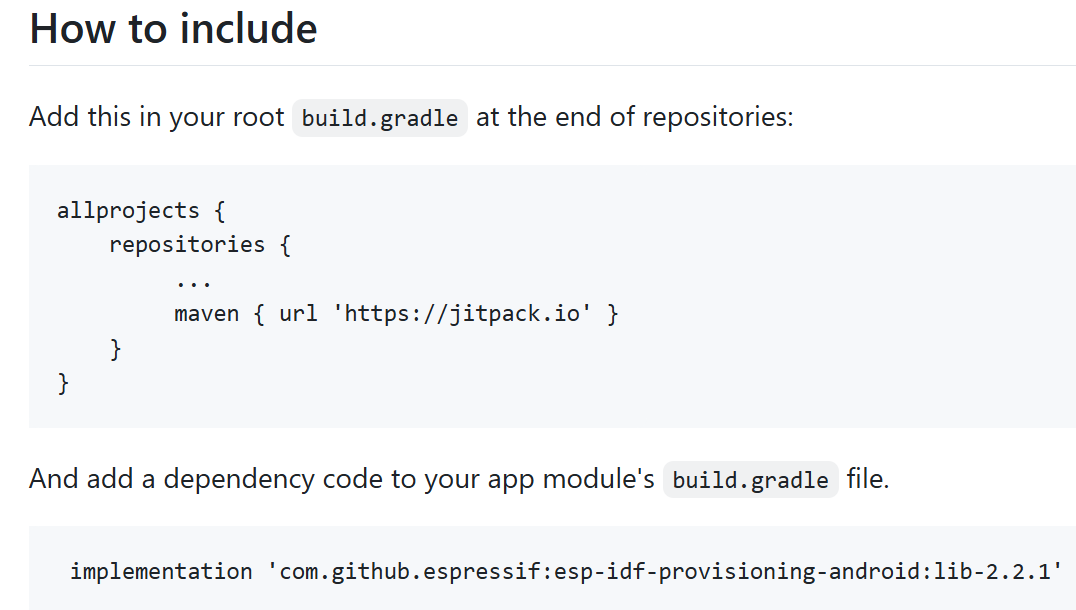

I am not sure where this question should go, if this is not the place let me know....
I downloaded Android Studio and imported the esp-idf-provisioning-android git and compiled and got lots of errors.
I then noticed there are 2 dependency things you need to add, as shown in the pic below, I can not seem to figure out how to add this.
Also is there a place with more documentation on the android app code?
Thanks!
Richard.

Compilation of esp-idf-provisioning-android should work directly, without the need of adding any dependencies. Dependencies need to be added only if you have some existing Android app into which you want to include the Provisioning libraries. If you are getting errors, even without making any changes, can you share the error log?
